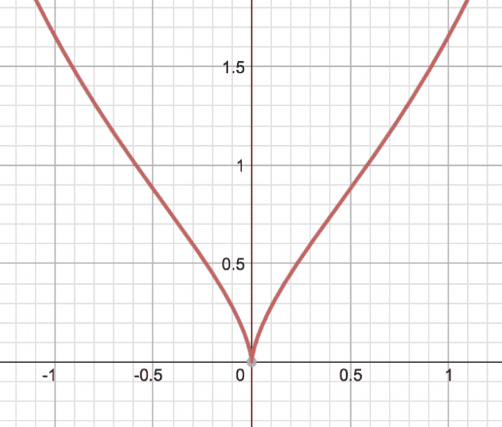

wabbit said:One thing I notice from this (should have been obvious I suppose from R=c/H, but it didnt strike me somehow) is that ##\lim_{T\rightarrow 0}H_T=+\infty##
What would really be nice would be google-calculable formulas that go back to the radiation-era and the start of expansion. No hope, just dream.

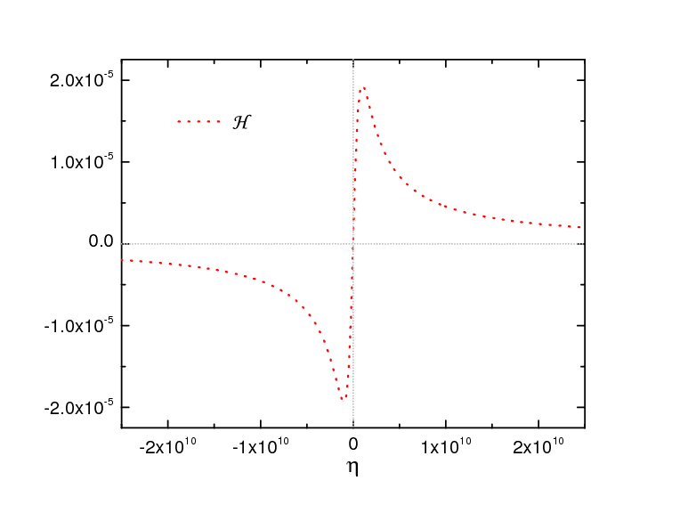

Wait. Ashtekar has a simple modification of the Friedmann equation with a density dependent term (suppressed at Planck scale) that only comes into play at extreme energy density. We should look at it.
BTW Cai and Wilson-Ewing put a slightly longer version 2 of their "LambdaCDM bounce" paper on arXiv around beginning of February. The paper has been published in JCAP. As I see it, that is the leading candidate for a simple cosmic model. no inflaton needed, no multiverse implied, no fluctuation ex nihilo. Instead of mythical add-ons, a bounce of something already familiar to us (that we can see and for which we already have decent equations) the ΛCDM
http://arxiv.org/abs/1412.2914
A ΛCDM bounce scenario
Yi-Fu Cai, Edward Wilson-Ewing
(Submitted on 9 Dec 2014, revised 28 Jan 2015)
We study a contracting universe composed of cold dark matter and radiation, and with a positive cosmological constant. As is well known from standard cosmological perturbation theory, under the assumption of initial quantum vacuum fluctuations the Fourier modes of the comoving curvature perturbation that exit the (sound) Hubble radius in such a contracting universe at a time of matter-domination will be nearly scale-invariant. Furthermore, the modes that exit the (sound) Hubble radius when the effective equation of state is slightly negative due to the cosmological constant will have a slight red tilt, in agreement with observations. We assume that loop quantum cosmology captures the correct high-curvature dynamics of the space-time, and this ensures that the big-bang singularity is resolved and is replaced by a bounce. We calculate the evolution of the perturbations through the bounce and find that they remain nearly scale-invariant. We also show that the amplitude of the scalar perturbations in this cosmology depends on a combination of the sound speed of cold dark matter, the Hubble rate in the contracting branch at the time of equality of the energy densities of cold dark matter and radiation, and the curvature scale that the loop quantum cosmology bounce occurs at. Importantly, as this scenario predicts a positive running of the scalar index, observations can potentially differentiate between it and inflationary models. Finally, for a small sound speed of cold dark matter, this scenario predicts a small tensor-to-scalar ratio.
14 pages, 8 figures, published in JCAP March 2015
