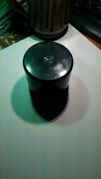

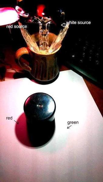

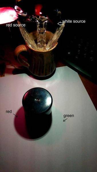

I exposed a black bottle cap by two light sources ( LEDs), one source is white and the other one is red as in the picture.
I noticed that one penumbra toward the red light source is reddish in color which makes sense because this area is only exposed to the red source. What makes a puzzle is the other penumbra toward the white source is green.
What is the reason? No green light source was in the room and the screen is a white paper.

I think this is a product of the materials color reflecting property, white light contains different wave lengths, something that is black usually absorbs light. This material is "glossy" so it reflects some light. My best guess is that the material is reflecting that particular wave length while absorbing the others.
http://www.physicsclassroom.com/Class/light/U12L2c.cfm
I took the image and chose a white balance point in the "green" part.
I
I tried with other material and I got the same effect.
I looked at the first photo and appears to be a green cast off from the brown mug also. I've noticed that LEDS tend to have a different effect then regular incandescent white light bulbs. The green penumbra may just be the product of shadow. Most white LEDS have a blue-ish tint. So this just may be the light source itself.
I copied this from Wikipedia , white LEDS are...
"The existence of blue LEDs and high-efficiency LEDs quickly led to the development of the first white LED, which employed a Y3Al 5O
12:Ce, or "YAG", phosphor coating to mix down-converted yellow light with blue to produce light that appears white."
Primary colors yellow and blue make...green?
If the green shadow is due to the light source, the exposed white paper with the white source only would yield a green hue too.
I exposed a blank white paper with the white LED and I used some apps to roughly measure the color of the area exposed to the white LED and I compared it with the color of the area which appears green in the first experiment. ( see the picture).
I could not find any green hues anywhere in the paper which is only exposed to the white LED. While the small shadow which appears green in the first experiment gets green color using that apps.
This means the white LED is not the reason for that green color.

This is not uncommon and it's often only when looking at a photograph that it becomes really obvious. Your eyes tend to compensate when looking at the real thing. Two different light sources, sunlight incadescent/ mfl / led / flash will throw their own shadows. The shadow will be largely filled in by other sources but, if the other source has a different spectrum, the shadow will appear coloured. The unshadowed part reflects a mix of the two lights (appearing to be the correct 'white' colour) whilst the shadow only reflect the light from one. The camera may automatically adjust the colour balance to bring the average of the scene to its chosen 'white' and any of the shadows will appear to be slightly different from the 'white'. Anything that's not the chosen white will appear to have a colour tint.
Photographers have to try very hard to avoid the effects of mixed illumination. Filling in interior shots with filament lamps can have some really weird effects that people in the room just won't be aware of.
Thank you for showing me how the camera can modify the colors of the scene.
But I even noticed that by my naked eyes before using the camera. I thought of a retinal compensation, but this may work in a narrow interface between two areas (something similar to Mach effect) unlike my observation that the whole shadow was green. I am not happy with both explanations.

I wasn't referring to transitions between areas. I was referring to the various 'whites' that are visible in your picture and others. There are many optical illusions in which a spot colour will appear different, in the same picture, when presented against two different local backgrounds. The eye does its best and it tends to be a lot better than the auto feature on a camera. It uses context and past knowledge to get the best information it can from a scene.
But the shadows in your picture are actually illuminated with different light so they will, of course, look different. That difference may show up more on a simple photograph than when viewing the scene by eye. If the background 'should' look the same, in the brain's estimation, then you will probably won't notice the differences.

That's one way of saying it but all three of the 'whites' that are seen - (the main area and the two penumbra) would all be considered to be white because the source LEDs are used as a white illuminant. What we perceive is not 'an illusion' but we can be presented with deliberate illusions that can fool us. As with many of our abilities, it's when they actually fail to work that we can begin to find out how they operate.
Let's face it, when you go outside in the winter, you would call the light 'white' and when you go indoors into a brightly lit room, you would also call the lighting 'white'. Likewise in a kitchen or office with cheapo flu tubes. None of those 'whites' are the true white because there is not one. Some are bluish, orangeish, greenish and, after five minutes with one illumination, you are quite happy to assess and match the colour of some clothing or paint. Within limits, you can usually get it right, too.
We needed to evolve with the ability to compensate for a variety of white illuminants but, during our evolution, we were never presented with LEDs, CFLs or mercury arcs so we never evolved to cope with them.

Do you conduct the experiment in total darkness, except for the visible bit of the screen, lit by just the LED?
Whatever you 'see' is psychological and the result of the actual spectrum of the light reaching your eye. What 'colour' is the patch of light to you? If it changes with and without the other light source present then some of that light is getting to the patch of screen. Nothing in this sort of experiment can actually alter the wavelengths of the light so it just has to be down to perception, comparison and memory. There are loads of papers about colour vision. The basic tristimulus theory that's applied to Colour TV just has to be pretty credible because 'everyone' who sees colour TV pictures, these days, agrees that they are pretty damn good.

OK, so you had one source of light, shining on a white /neutral screen. How would you be seeing anything other than the effect of that light source? Anything you saw was interpreted by your brain as a very desaturated colour. I would suggest that, if you woke up in the night and that's all you could see, you'd probably have assessed it as white.
Is there anything more to it than that? (i.e. any other experimental detail)
I wonder, for instance, just how non reflective your black card was. It is actually very hard to get a 'good' black with paint or printing.

QA It's not green, it's cyan the opposite of red.
It's cyan not green, cyan is the opposite of red. Magenta is the opposite of green. Shadows tend to take on an opposite hue.
