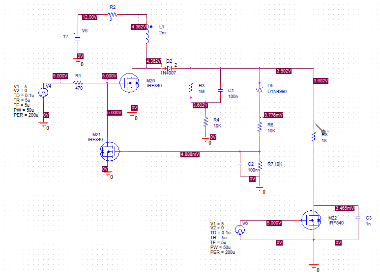

I have a circuit which can produce bursts of 500V. When I did this circuit, The 2.2 mH is burning. I want to know whether do we need to take care the power rating of inductor?
After the test I tried the experiment without inductor too. I have used 2.2ohm, 1W resistor. That too started to burn. Can anyone help to rectify the problem?
The burning of L1 may be due to:
1) Too big conductive losses in the coil.
2) Too big magnetic ( hysteresis ) losses in the core.
In case of 2), use another core with an airgap, thereby reducing the magnetic losses.
Most of the variation of magnetic energy in the core will take place in the airgap.
Recalculate the core used, the number of windings, etc.
Something like this:
www.mhw-intl.com/assets/EPCOS/RM/B65813%20RM-10.pdf
( B65813-+400-A48. Number of windings = 74 @2.2 mH )
I assume that you could have used something like a toroidal core without an airgap.
Short circuiting L1 will prevent the circuit to oscillate properly, thus burning R2.

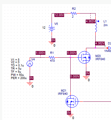

Can anyone tell the power ratings of the components that can I use in the above circuit? I couldn't rectify the problem that present with the first stage(First MOSFET) of the circuit. The second and third stages (Second and third MOSFETs) are working fine, as I expected. I need to know how can we calculate the current needed from the source.
Seems to me your trouble is not component ratings , your trouble is V4 not behaving .
If V4 is a 0 to 5 volt rectangular waveform with 25% duty cycle(high for only 50 usec out of every 200),
why does it show 5.000 volts instead of 1.25 volts ?
How then does M20 ever turn off ?

I recommend a core with an actual airgap.
The inductance depends on the amount of magnetic energy in the core, created at some current. This energy is proportional to H*B. If you sketch a B(H) hysterisis curve as for the magnetic material, the magnetic losses in the core will be proportional to the area of the hysterisis loop. These losses will be converted to thermal energy ( heat ).
With an actual airgap, most of the magnetic energy will be concentrated in the airgap ( where the H-field is very large ), but there is no hysterisis at all in air/vacuum, thus no losses in the airgap. That's why many inductor cores are provided by an airgap.
Introducing an actual airgap, you will make the core inhomogenous, dividing the magnetic energies into two parts, the smaller part with losses, the larger part with no losses.
This,
7.632 volts across R2,
suggests >3.8 amps through L1
Hesch's most excellent advice will keep it out of saturation.

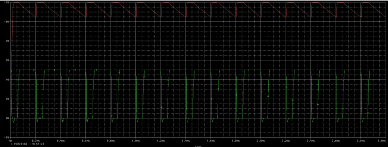

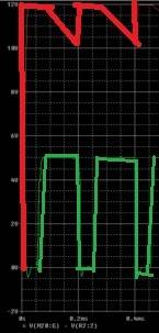

the voltage displayed in the circuit are bias voltages
What then are the actual voltages ?
Red one across 2 Ohm and green at Gate of first MOSFET
okay, thanks
i drew them in so they're visible.
It's so difficult to communicate with precision using just words. That's why a picture like this is so helpful.
""""Red one across 2 Ohm..."""
Surely you mean "Red one is voltage BETWEEN NODE R2-L1 AND CIRCUIT COMMON",
which is voltage(to common) at right end of the two ohm not across the two ohm.
because
IF Red is the voltage across the 2 ohm,
THEN six amps are flowing through it when mosfet is gated OFF.
IF I'm right as to what your picture shows
THEN it looks to me like that part of the circuit is working fine.

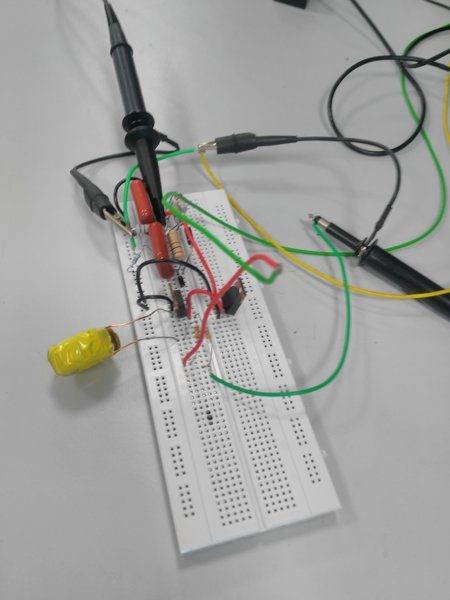

I am checking the first part of the circuit. I have a toroidal Inductor which can pass upto 3.4Amps. Now the inductor working fine, but nothing seeing at output. Is that because, the resistors and capacitors used are of higher power ratings?
Hi Nikhil
building a circuit like that on a breadboard is about the worse thing you could do !
No wonder you have been having problems. They are not designed for higher currents and voltages
you really need to be soldering all the connections together in a more normal circuit construction ( WITHOUT a breadboard)
so that it eliminates the possibility of burnt out connector strips in the breadboard due to the currents
that could be passing through poor joints
EDIT ... just to clarify ... I'm making these comments because of your references to
500V pulses and inductors passing more than 1 ADave

Now I have done the same circuit in copper pcb, with soldering. But I am using signal generator to give the switching pulses to the MOSFET and I am using DC power supply for giving 12V Vcc. So will there be issue with ground? Does the circuit needs pull-down resistors ?
R8 & M22 remove a LOT of energy from your circuit.
If you lift R8 your regulator should reach around through M21 and hold output about 400 volts.
That'd check your flyback high voltage source part of the circuit.
Observe 400 volts across 1 k ohmR8 is 160 watts. With 25% duty cycle on V6-M22 that's 40 watts.
I don't think you can squeeze 40 watts through your 2 ohm R2 with only 12 volts . Try the maximum power transfer theorem, I get 18 watts.
One step at a time - get your step-up flyback stage working , then load it up.
I want to praise you for building this circuit out of real parts. One learns SOOOO much more that way.
Bravo, Nikhil !
keep us posted ?
old jim
I see a few issues with the circuit.
The following assumes, but is not limited to, the no load condition, i.e. R8, M22, C3 removed.
The R2 - L1 time constant is 1mS, however the pulse width is only 50uS (1/20 time constant). Consequently the inductor current and output power will be very low.
The R7 - C2 time constant is 1mS, much longer that pulse repitition rate. Expect some output overshoot; perhaps enough to damage M20 due to overvoltage.
Zener diode D5, 1N4996, is rated 390V. Taking account of 5% tolerance of D5 and M21 threshold voltage yields an output voltage between 375V and 418V.
Voltage drive to M20 Gate is marginal, I suggest a few more volts to ensure reliable switching.

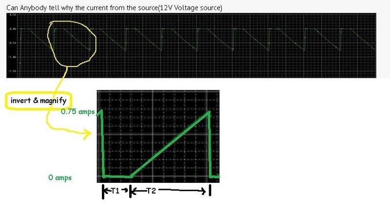

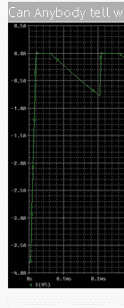

Can Anybody tell why the current from the source(12V Voltage source)
goes negative side?
Nikhil N said:
Can Anybody tell why the current from the source(12V Voltage source) goes negative side?
Not without knowing how you measured it.
Where are your oscilloscope leads connected ?
More confusing is why does it start at 4 amps not zero ?
I don't believe your trace is current,
i think it's voltage between node R2-L1 and circuit common.
Which when subtracted from Vsupply(12) and divided by two gives the current
done graphically here
Current WILL flow in accordance with laws of Ohm and Kirchoff.
When you measure something that disagrees with those laws, it's a mistake .
If you believe current is flowing the wrong way,
and expect us to be able to help,
you'll have to explain why you think it's flowing backward.
Could be as simple as a pass-through current robe on the wrong way. The arrow on current probes indicates direction of conventional current ..
