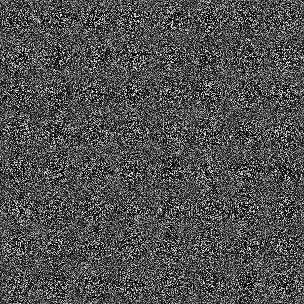

wle, you're my shining knight :kiss:
Brilliant! Exact match. Even brillianter is that I just ran the output through ENT (Fourmilab) and got...
Code:
C:\scratch>ent jkiss32-1gb.bin
Entropy = 8.000000 bits per byte.
Optimum compression would reduce the size
of this 1000000000 byte file by 0 percent.
Chi square distribution for 1000000000 samples is 266.30, and randomly
would exceed this value 30.07 percent of the times.
Arithmetic mean value of data bytes is 127.5008 (127.5 = random).
Monte Carlo value for Pi is 3.141699301 (error 0.00 percent).
Serial correlation coefficient is -0.000009 (totally uncorrelated = 0.0).
Looks pretty good eh? I've attached a picture of the JKISS output I know readers are dying to see. Thanks again.
I've got the main() thing covered. I only presented the code in this fashion for brevity.
