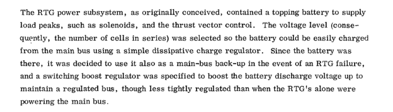

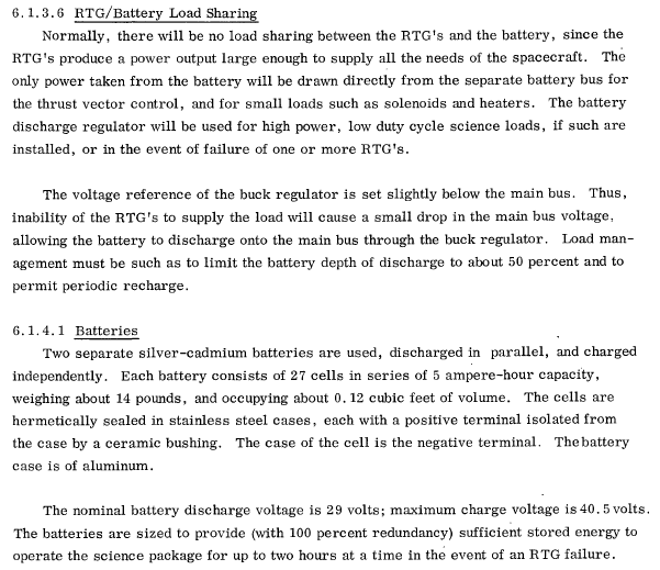

It's really a chore to dig through all the trash google can throw up, but finally I've found a relevant-looking document:
Supplement to Voyager RTG spacecraft design definition, Voyager Task C
I cannot tell if it's about the design phase or about the final spacecraft, but there are some interesting details (page 39, as a PDF-page)
On page 42:
Ps.: I've found one more relevant document: 'Phase 1A Study Report - Voyager Spacecraft' from 1965

Would the battery have sustained viability after all these years is one question to ask,
Another is the heating system for electronics and the battery itself.
Operating temperatures would have to be reasonable - perhaps as low as 0C for these things to function properly.
If the RTG was sending power to a battery heater to keep the battery up and running in standby mode, then that is a continuous 'loss' that could be put to use for the instruments when the time comes for the low power considerations.
The battery can supply only x amount, and then it has to be re-charged from the RTG.
If it was me,( and that is where my answer was coming from when I mentioned that there is no chemical battery or caps available since they would only be a typical ramp up-ramp down procedure - one might have to drop an instrument to re-charge ) I would shut off the heater to the battery and use that power for the instruments to keep them running a bit longer in duration. If it is going to fail it's going to fail and with luck on your side..... I think that is where the 'The circuit can access a small amount of power from the RTG that’s set aside for this purpose.' comes from.
Not sure but as an engineer, if the system has been quite reliable so far, with its orientation basically constant and with no more flybys of planets, electrical backup and voltage regulation from the battery circuit might not be needed anymore.

It might not be the right answer, but to me, it does make some good sense. At the start, the RTG is going to be putting out max voltage. They can afford to 'waste' it in a regulator, as the source is putting out what it will, you can't conserve it (production-wise) in any way, though you could (and apparently do) store excess in a battery. They could maybe use a shunt regulator for low drop-out, but that might require too much wattage to be practical in this application. But once the RTG has dropped low enough to not pose an over-voltage threat, it could make sense to bypass a series regulator.
I'll try to get through the documents that were posted later (might not be until tomorrow), but it does appear that type of silver-cadmium battery could last 45 years? I have not found much info on them, they aren't used much because they are so expensive, but cost isn't much of a factor for space missions.
Looks like shelf life, power/weight, and flat discharge curve were the magic combination.
