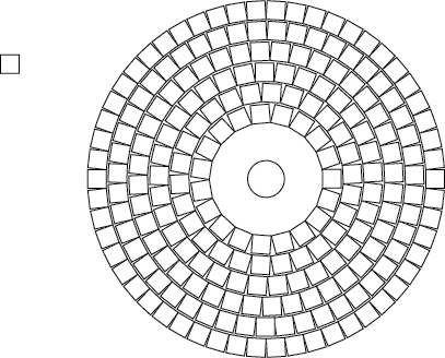

I'm currently designing a circular patio using 6-in square blocks in concentric circles. While using a combination of Excel and Adobe Illustrator, I uncovered something unexpected. Each new circle required a consistent number of additional blocks, when rounded up to the value of a whole block. 7 to be exact. It is my goal to understand how and why this works, and hopefully to learn a formula that will let me repeat it and change things like block size.
I began with a 36-inch circle which would be a firepit. I determined I would need 18.85 6-inch blocks. I'm not planning to cut them, so I rounded up to 19 blocks and backed into the circumference that would accommodate it (114 inches). I went to the next ring and more or less repeated the same process: approximated circumference, determined a fractional number of blocks, rounded up to nearest whole block, backed into precise circumference. Rinse, repeat.
After about six rings, I wanted to know how many rings I'd need to get to a 16-foot diameter, so I figured I'd average the diameter increase between each consecutive ring, hoping to extrapolate an estimate. I was surprised to find each circle was the exact same increase from its adjacent circle (1.114085 ft). And that's when I noticed the consistency in the blocks.
If I was aiming to have circumferences that accommodated only whole blocks, I learned that each new circle required exactly 7 additional blocks.
How is this so precise and predictable? I'm assuming it has something to do with effectively turning the circle into a polygon by using blocks, since they are flat. So the first "circle" is really a 19-sided polygon, the next a 26-sided polygon, etc. But I don't know the first thing about complex polygons.
Furthermore, I'd love learn HOW this works. If I had a formula of some kind, I could change the size of the blocks at will and speed up my estimates.
Thanks for any help! Attached an image for reference
