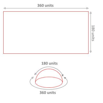

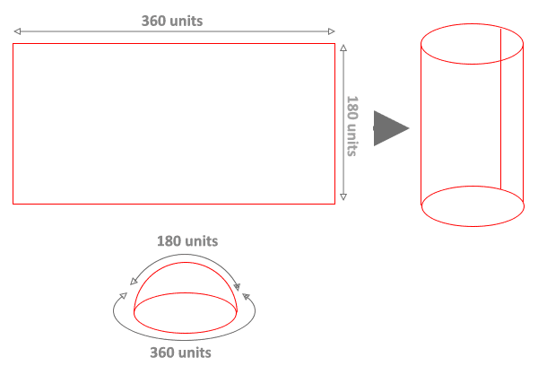

Do the top and bottom objects look to be the same area?
If you took a sheet of paper the size of the top rectangle and tried to fold it to make the bottom shape, what do you think would happen to the paper?

The 180 units are measured from north pole to south pole=over the whole sphere=referring to post 6, also in reference to post 5.
Thanks for all your responses! I have the answer to my 2nd question, my naive assumption was grossly incorrect. But what about my first point?
