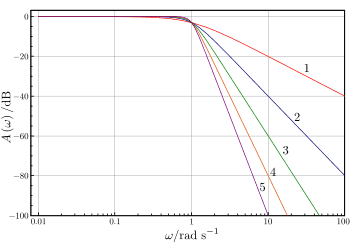

An ideal filter will act like a brick wall, have constant gain in the passband, and zero out signals beyond the intended bandwidth. No real circuit can do that and in real life there is a rounded tailing off of the filter characteristics as you've spotted. Lower order circuits will have more gradual characteristics and higher order circuits (higher sn which is equivalent to more Cs and Ls) will have steeper characteristics.
The bandwidth of a signal (as opposed to a filter) gives an idea where in the frequency domain most of the signal's energy resides and is usually defined the same way. But it may be defined differently if the fidelity of the signal is important -- ie you may decide the bandwidth of a signal should contain 90% of the signal's total energy. This way you'd design your filters to allow 90% of the signal's energy to pass without much modification. Using a 3db definition may cause significant portions of the signal's energy to be distorted, which may be undesirable.
This plot shows how the use of a higher order filter improves the steepness of the cut off..
Unfortunately life is never simple and the use of higher order filters can introduce other problems such as the need to use non standard value or very tight tollerance components.

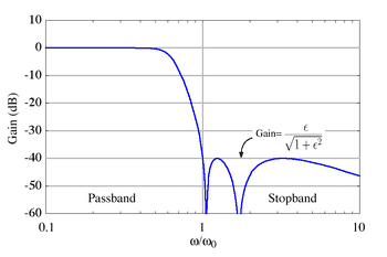

There are several different types of filter, usually named after the person who invented it. These typically trade off one characteristic for another. For example they may improve the steepness of the cuttoff at the expense of a few ripples or peaks inside or outside the pass band. Another example..
Which you use depends on the application and if it can tollerate the side effects.
