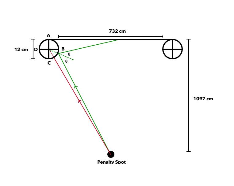

And how did you get ##d>S\sqrt 2\cos(\frac{\pi}4-\theta)##?
Also I hope that this diagram is now correct,

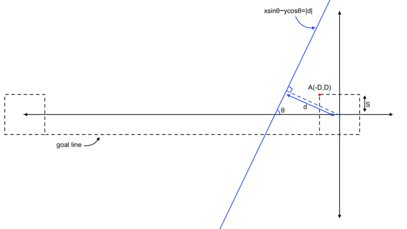

Draw the trajectory passing through A=(-D,D).
If its nearest point to the origin, O, is B, what is angle BOA?
Yes I get OB=##S\sqrt2\cos(\frac{\pi}{4}-\theta)##, next step?

I thought you calculated the probability of a shot going in after hitting the post, this was what I was originally asking, "of all the shots that hit the post which of the two posts (square or round) has a greater probability for those shots going in"
kshitij said:
this will not give the cases when the ball goes in after deflection from the post
It will. Draw the diagram for ##\theta>\pi/2## and d just sufficient to pass to the right of A.

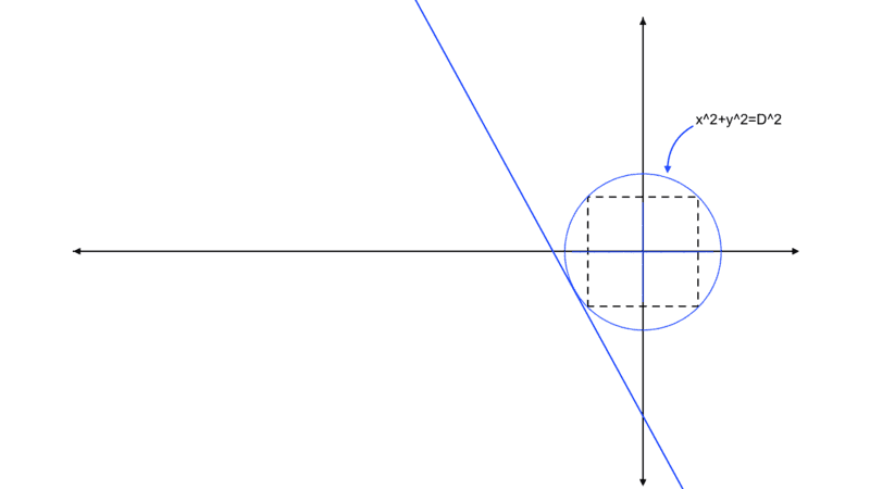

The blue circle is of radius ##D## and if the path of the ball is tangent to that circle (because ##d## is the perpendicular distance of the path from origin and this distance is equal to ##D## in the limiting case) it will not hit the post
I realized you said that the limiting case is ##d=D\cos(\frac{\pi}{4}-\theta)## not ##d=D## but now I cannot understand why?
What I do understand is that ##\left|\frac{\pi}{4}-\theta\right|## is the angle between the vectors ##\vec {OA}## and ##\vec {OB}## where ##\vec {OB}## is the perpendicular distance from origin ##O## to the path of the ball and ##D\cos(\frac{\pi}{4}-\theta)## is the projection of ##\vec {OA}## on ##\vec {OB}##

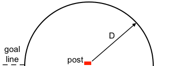

D is all possible values of the distance of the path of the ball from origin starting from the edge corner of one post to the edge corner of other (the other post was
No, D is a constant such that if d>D then it is sure to be a goal without touching the post. Likewise, if d<-D it surely will not be a goal. D's value won't matter as long as it is large enough.
We only need to compare the posts for what happens when -D<d<D.
