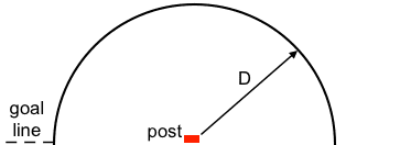

Also, I have another doubt,
Say if I set the value of ##D=R## in the round post, then it should mean that now I'm considering only the shots that hit the round post, so now I get the probability of a shot hitting the round post going in as
##P(round)=\dfrac{D\pi-2R}{2D\pi}=0.18##
But that seems logically incorrect as this probability must be atleast 0.25 (as any shot hitting sector AB {see the second diagram in post #1} must go in). What is wrong here?

If the ball comes from ##(D,\theta)## in polar then, of the whole ##2\pi## range of angles it can go in, only a sector of angle width ##\theta## is headed for the goal. The probability of a goal is therefore ##\frac \theta{2\pi}##. Integrating, the overall probability is ##\frac 1\pi\int_0^\pi\frac \theta{2\pi}.d\theta=\frac 14##.
The probability we calculated before is what I defined it to be: the probability of a goal if the angle of the trajectory is uniformly distributed over its legal range ##(\pi)## and its displacement from the centre of the post is uniformly distributed over (-D,D).
Changing it to the shot being made from an arc of radius D, uniformly distributed along the arc, leads to a different distribution of trajectories and a different probability.
I note that throughout this thread you have not really understood the importance of clearly defining the assumed distribution. This is fundamental to dealing with probabilities.

I think that you assumed that a shot is hit from a point on the arc of a semicircle of radius ##D## but I meant that a shot hit from any point in the area of the semicircle of radius ##D##, because now we see that ##\theta## is uniformly distributed in ##(0,\pi)## and ##d## (displacement form the center of the post) is uniformly distributed in ##(-D,D)##.
  • #140
kshitij said:
I meant that a shot hit from any point in the area of the semicircle of radius D,
That's different again. And it's messier because now there are three degrees of freedom to integrate over instead of two.

I just want to visualise the probability, saying that "this is the probability when the path of the ball is such that ##d## and ##\theta## are uniformly distributed over ##(-D,D)## and ##(0,\pi)## respectively" doesn't give me any hint about what is happening physically. Saying that "this is the probability when the path of the ball is always intersected in a semicircular area of radius ##D##" gives a much better understanding of how the ball is hit.

If the ball is coming at angle theta from a uniform distribution of points in the semicircle then there are two degrees of freedom just to specify the point.

Why can't I pick any point in the semicircle and any angle from that point that's in the 180 degree range?
For every point you pick we can define a unique line which is perpendicular to the line joining that point and origin
  • #148
I was trying to define the equation of the line in parametric form with a given slope and given distance (perpendicular distance) from origin
  • #149
If you pick a point from a uniform distribution over the semicircle and an angle uniformly distributed ##(0,\pi)## then look at the distance d that path is from the origin you will not get a uniform distribution for d in (-D,D), so the probability of a goal will be different from what we previously calculated.
  • #150
the distance of the point from origin will also be the distance of the line from origin as the line is perpendicular to the line joining origin and that point so you don't need to look at ##d## again since you already fixed that while picking the point
