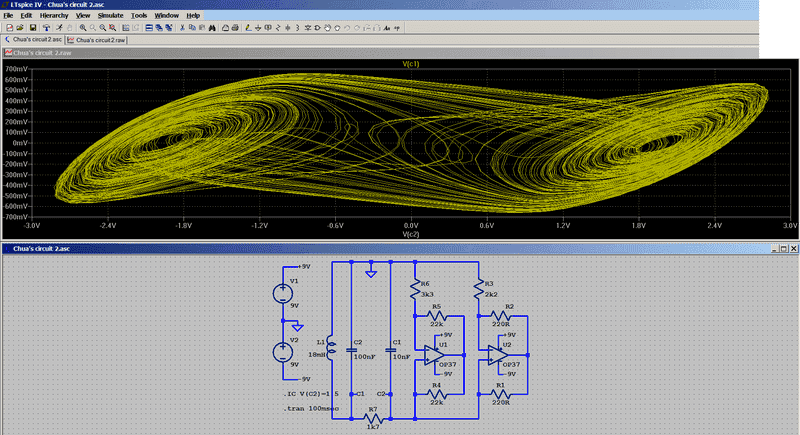

Attached is a spice simulation of Chua's circuit.
Remove the .txt extensions to run the .asc file in LTspice.
