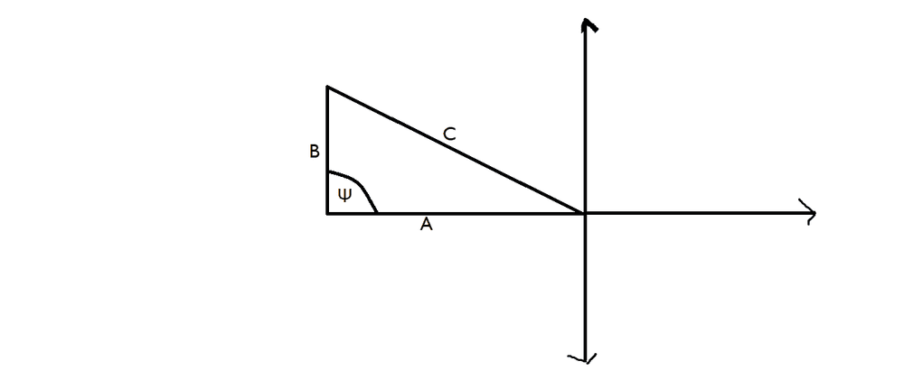

In case of right angled triangles, C^2 = A^2 +B^2 - 2AB cos(Ψ) is shortened to C^2 = A^2 +B^2 because the cosine of the angle "Ψ" which is 90° is equal to 0. But how is its cosine equal to 0.

##\cos{90^{\circ}} = 0##

SSG-E said:
Summary:: In case of right angled triangles, C^2 = A^2 +B^2 - 2AB cos(Ψ) is shortened to C^2 = A^2 +B^2 because the cosine of the angle "Ψ" which is 90° is equal to 0. But how is its cosine equal to 0.
IView attachment 264987
You can find the proof of Law Of Cosines in some Trigonometry books and some Calculus books. There is an old book by Anton which includes a proof.
My favorite proofs are propositions 12, 13 Book II, Euclid's Elements.
cos 90 = sin(90-90) = sin(0) = 0.

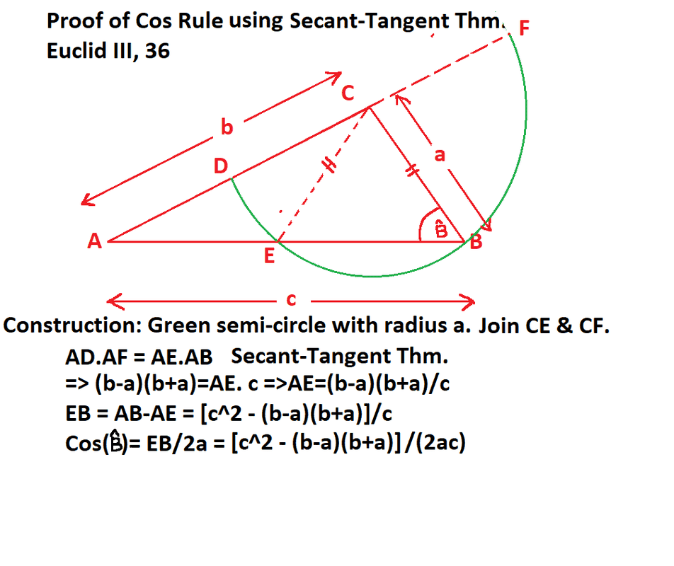

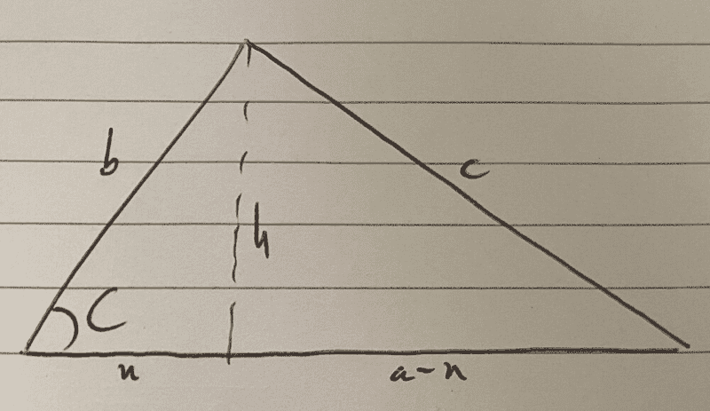

Another way, label the triangle like this:
Pythagoras on the left triangle: ##x^2 + h^2 = b^2##
Pythagoras on the right triangle: ##a^2 - 2ax + (x^2 + h^2) = c^2##
Now since ##b\cos{C} = x##, we finally have ##a^2 + b^2 - 2ab\cos{C} = c^2##.

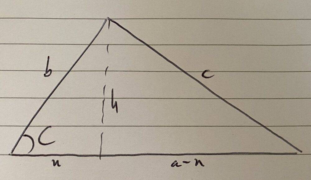

😁 Oh you English people! I can see that you have not even used the scale for drawing that perpendicular ##h## and that ##h## is very pointy, it has sharp end points. It’s really an English’s writing (so tough to read).

neilparker62 said:
##h=b\sin\hat{C}## and ##x=b\cos\hat{C}##. Hence:
$$c^2=b^2\sin^2\hat{C}+(a-b\cos\hat{C})^2=a^2 + b^2 - 2ab\cos{\hat{C}}$$, and as a 'bonus': $$\tan\hat{B}=\frac{b\sin\hat{C}}{a-b\cos\hat{C}}$$It
