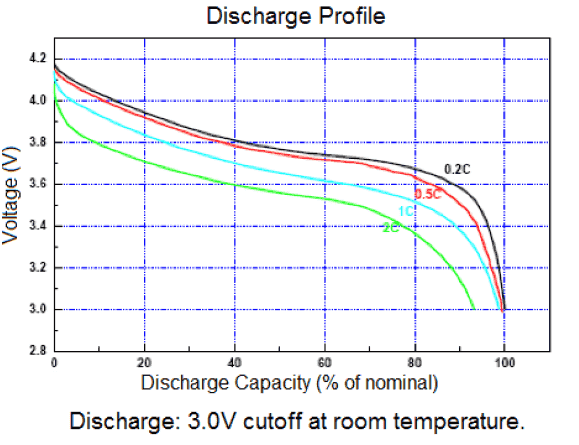

You must start with a nonlinear discharge curve similar to this one for a LIPO battery. Note that voltage versus discharge is nearly flat, not exactly flat.

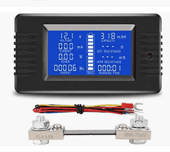

Then you are trying to reinvent a battery monitor similar to those listed in #9, correct?
The monitor illustrated in #9 lists for less than $19 on Amazon. So you won't save money. Perhaps you are looking for the learning experience of a DIY project

The description says:
bayite DC 6.5-100V 0-100A LCD Display Digital Current Voltage Power Energy Meter Multimeter Ammeter Voltmeter with 100A Current Shunt​
