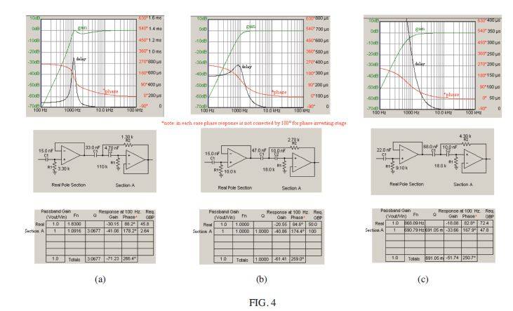

Write a report (of approximately 750 words) that discusses and compares
the design of each filter in terms of their performance, circuit topology,
application and any other relevant characteristics. You may for example
attempt to relate the choice of component values to the filters
performance.
[tex]f_c=\frac{1}{2{\pi}RC}[/tex]
The topology of the of the circuit is a first order high pass filter followed by a second order Sallen and key.
As the first part is an RC high pass buffered circuit, I believe the TF can be cascaded (multiplied).
I'm unsure how to work out the corner frequency
Do I work out each part of the circuits Fc?
or is there an overall equation for this circuit
The response of the overall circuit must be to do with the Q factor of the Sallen and key
All help is appreciated
Thanks

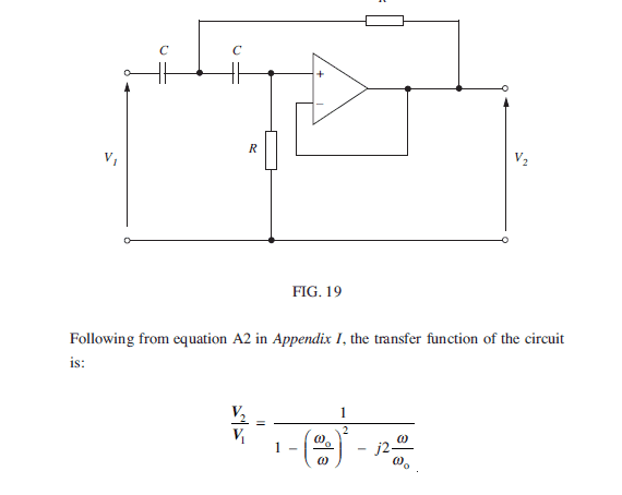

the TF for the second order S&K
[tex]\frac{V_{out}}{V_{in}}=\frac{1}{1-\left( \frac{{\omega}_o}{{\omega}} \right)^2-j2\frac{{\omega}}{{\omega}_o}}[/tex]
"So it is the response of the circuit dictates whether it's a Butterworth or Cherbyshev. Not the circuit design."
The response of the circuit (the transfer function) is the RESULT of your design. Do you think both would be not correlated?
And no - the transfer function is not correct (sign error).
More than that, this is not the GENERAL function - expressed using wp and Qp.
When you are required to write a filter report, it is necessary to know - at least - the terms and the general 2nd order function.
This is the TF given in my learning material is this wrong?

View attachment 110010This is the TF given in my learning material is this wrong?
Yes - it is not correct. It is a highpass circuit - and the transfer function magnitude must approach a finit value for very large frequencies.
The last part of your function would cause the magnitude to approach zero for very high frequencies.
