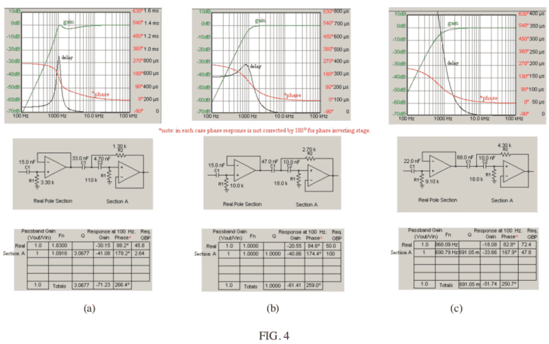

The filters of FIGURE 4(a) to (c) where designed using a commercial software package (http://focus.ti.com/docs/toolsw/folders/print/filterpro.html)
Write a report (of approximately 750 words) that discusses and compares the design of each filter in terms of their performance, circuit topology, application and any other relevant characteristics. You may for example attempt to relate the choice of component values to the filters performance
Figure 4 with three columns (a), (b), (c), each showing a high-pass filter's gain, phase and delay plots, its circuit schematic and a design results table.
Transfer function equation: Vout/Vin equals 1 divided by (1 - a(jω/ωo)^3 + b(jω/ωo)^2 + c(jω/ωo)), a third-order high-pass form.
So far I have found that each of the circuits contain both a 1st order and second order filter cascaded to form a 3rd order filter. I am now looking at the graphs shown to analyse the data such as frequency response / phase response of each circuit.
I have some questions relating to chebychev vs butterworth. Can I determine which of these by simply the frequency response. I see that (a) is chebychev (b) is butterworth and (c) possibly butterworth or bessel..
Is it ok to determine these in this way or I am I totaly off the mark?

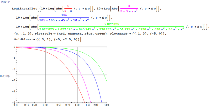

In the frequency domain the Bessel never has ripple in either the passband or stopband regions but the Butterworth can look almost as flat as the Bessel yet still have some overshoot. The Chebyshev always has passband ripple, usually pronounced.
The other differentiator is phase reponse, just as important as frequency response.
The different filter types are tradeoffs between rapidity of rolloff (chebyshev best), flatness (Bessel is best) and phase linearity (Bessel is best). Butterworth is a compromise between Bessel and Chebyshev - little ripple and acceptable phase linearity.And then there are still other response scenarios, e.g elliptic.

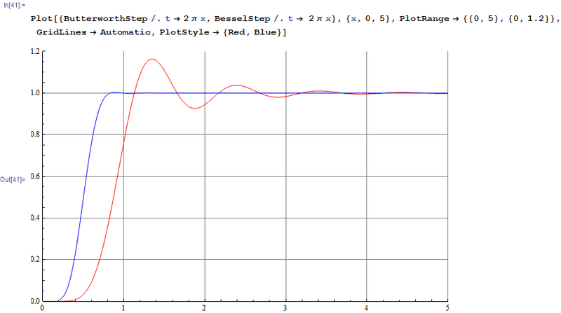

The best way to appreciate the effect on a pulse shape by the various filter transfer functions is to take the Fourier integral of the pulse, multiply by each of the Fourier transforms of your various filter transfer functions, and inverse-Fourier transform the outputs. (You can do this with Laplace transforms also, in which case jω is replaced by s in the filter transfer function).
You can also take a simple transfer functions like 1/(1+jωτ), input the transformed pulse, and inverse-transform the output, varying τ while keeping the pulse duration constant. You know the phase of this network is φ = -tan-1(ωτ) so dφ/dω = -τ/(ω2τ2 +1) so you can see how dφ/dω is low if ωτ << 1 and also you know separately that this 1st order low-pass filter will have minimum pulse distortion for this condition since then it approaches a constant gain without frequency effects. So there is an obvious correlation between phase response and pulse distortion.
I think, I should mention some corrections:
It is not quite correct that the Bessel response is best - as far as "flatness" is concerned.
Another name for Butterworth response is "maximum flat" response.
That means: Butterworth is between Bessel and Chebyshev because it has a maximum flat response WITHOUT any peaking !

Actually, the answer is (b). You have to concentrate on the constancy of the passband group delay which is to the left in your delay graphs. It's not the amount of delay but its lack of variation (flatness) with frequency that is of import. So the delay in (a) varies more than that in (b) even at low frequencies, making (b) the closest to a Bessel response.
What is called "delay" in your graphs is "group delay" which is dφ/dω and so has the units of time. So you can also see that phase φ itself should increase linearly (in a negative directon) with frequency ω to attain a constant group delay. The integrity of a pulse correlates directly with the constancy of group delay with ω.
Yes, I was looking at the graphs comparing them as if they had the same time scale but I see now that (a) varies more in time. I had it backwards sorry, so (b) is the best case which compromises in all 3 aspects being frequency roll off, flatness in phase response and group delay to provide the best case in terms of minimizing distortion?
Right. Flat delay (vs. frequency) = low distortion (vs. time).

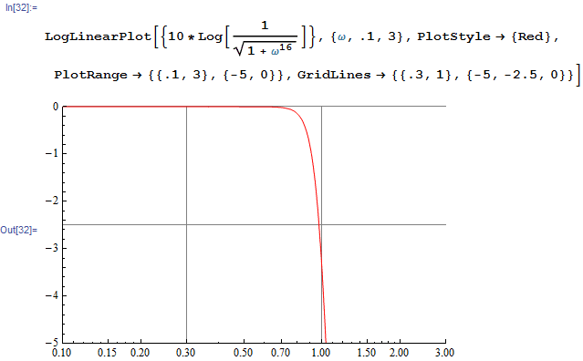

rude man said:
True. I should have said that Bessel has no ripple wheras Butterworth usually does. But in any case that's not the OP's focus.
Butterworth filters have no ripple.
From: https://en.wikipedia.org/wiki/Butterworth_filter: "The frequency response of the Butterworth filter is maximally flat (i.e. has no ripples) in the passband and rolls off towards zero in the stopband."

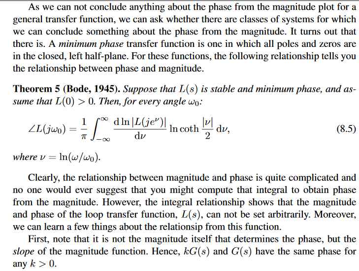

The change in phase is caused by the change in frequency response. If you know the frequency response of a filter which has no singularities in the right half plane, the phase response is completely determined by that frequency response.
Printed textbook page on minimum phase transfer functions, stating Theorem 5 (Bode, 1945) with the integral equation (8.5) relating phase angle of L(jω0) to the derivative of ln|L(je^ν)| with respect to ν, where ν = ln(ω/ω0).
Butterworth is not necessarily montonically non-increasing with frequency (for a low-pass). whereas Bessel is. I considered Butterworth "ripple" but better is "over-shoot".
The above does not hold for an all-pass network which has zeros in the right-hand plane. It does for the three networks the OP initially posted.

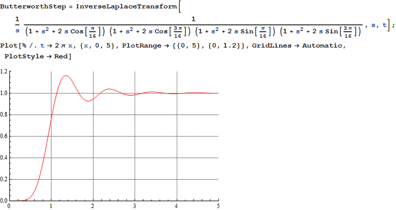

A little past halfway down the page under the heading "Maximal flatness" at: https://en.wikipedia.org/wiki/Butterworth_filter
is found "the derivative of the gain with respect to frequency can be shown to be...monotonically decreasing for all ω since the gain G is always positive", which is even stronger than "non-increasing".
Why would anyone suppose that it does, since it excludes networks with singularities in the right half plane?
Look at my attached link from Analog Devices for yourself. "The gain is always positive" does not preclude a bump in the G-w characteristic anyway. If it had said "dG/dw is always negative" that would be different. I've worked with A/D for 30+ years and they're a pretty fair bunch of EE's.

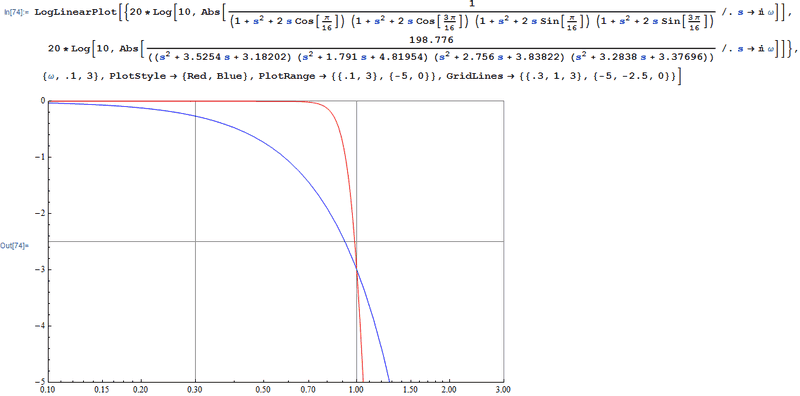

Are you referring to the link in post #3? That link doesn't work, but I think I found what it should be: http://www.analog.com/media/en/trai...-Linear-Design/Chapter8.pdf?doc=ADA4661-2.pdf
On page 21 under the heading "Butterworth", it says: "The Butterworth filter is the best compromise between attenuation and phase response. It has no ripple in the pass band or the stop band, and because of this is sometimes called a maximally flat filter."
The Wikipedia page I linked to: https://en.wikipedia.org/wiki/Butterworth_filter, under the heading "Maximal flatness",shows an expression for dG/dw. The fact that the gain is always positive means that dG/dw is always negative, even though that is not explicitly stated. The next sentence concludes from the properties of dG/dw that "The gain function of the Butterworth filter therefore has no ripple.".
The term "ripple" always refers to the frequency response (Butterworth is maximally flat without any ripple), whereas the term "overshoot" must be used for the step response only (time domain).
Is it ok to determine these in this way or I am I totally off the mark?
If you say (b) is a Butterworth, then you can't say (c) is also a Butterworth, because Butterworths have a fixed shape and you can see that (c) is not as sharp at the corner. So (b) may well be a Butterworth, but it then follows that (c) cannot be a Butterworth. Sure, suggest (c) to be a Bessel.

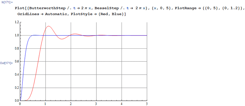

Not explicitly stated because wrong.
Looky here: see the bump on the Butterworth frequency response? Have to look carefully maybe ...
What is the significance of the small rectangles at points along each of your plots?
Your guess is as good as mine. Look like data points on empirically derived data but everything in this 144-page app note is seemingly computer-derived. And I see them only on the Chebyshev, not the Butterworth or Bessel curves.
I know my link wouldn't open so I suggest googling "analog filters" and finding "Chapter 8: Analog Filters - Analog Devices" which is how I found the paper. All you ever wanted to know about analog filters and then some.

There is also "overshoot" on frequency plots. Let's not get pedantic. See my post 26.
As I said already, all this is of no relevance to the OP who simply wondered about the relationship between pulse distortion and dφ/df flatness (cf. his last posts, ##7 and 11).
NascentOxygen said:
You are listing low-pass characteristics, but is any of this relevant to the high-pass filters shown?
It is.
Consider simple illustration: a rectangular pulse of duration T into 1st order low-pass and high-pass networks, cutoff radian frequency = a:
Input is (1/s)(1 - exp(-sT).
Low-pass is a/(s+a) and hi-pass is s/(s+a).
Group delay is the same for both: dφ/dω = -τ/(ω2τ2 +1) with τ = 1/a as I derived earlier.
Output for the low-pass is 1 - exp(-at) - [1 - U(t-T)exp(-a(t-T))]. This is a distorted pulse with slow rise and fall times but a flat top (for T >> 1/a).
Output for the high-pass is exp(-at) - U(t-T)exp(-a(t-T)) which is also a distorted pulse with sharp rise and fall times but a drooping top (for T >> 1/a).
Totally complementary situation. Both filters distort the pulse, but in different ways.
Further: dφ/dω of the input pulse = -T/2.
So the total delay of this pulse into a network with linear phase over all ω (in which φ = -kω so dφ/dω = -k) would be -T/2 - k
which proves that a network with linear phase over all ω would not distort the pulse anywhere.
