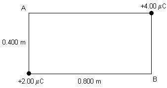

Two point charges are placed at the opposite corners of a rectangle as shown. What is the Electrical Field magnitude at each point due to the charges?
Pythagorean theorem, E=kq/r^2
r= square root of .8^2 +.4^2 =.89
E= 8.99x10^9 X 4X10^-6 divided by (.89^2)
E=8.99x10^9 X 2X 10^-6 divided by (.89^2)
should I not be dividing by .89^2 but rather the radius of an electron?
I am not sure if A and B should be negative or positive or if I am doing this right..?

A and B are points, they are neither negative nor positive.
However, you do need to bear in mind that the electric field is a vector - you only have the equation for the magnitude.
Note, charge 1 is twice the size of charge 2.
For each point, one charge is twice the distance that the other charge is.
It's worth thinking about this - if you double r, then E goes down by... but what if you also double q? ... halve q?
I don't really understand because to find the vector i need to use square root of e in the x direction squared + e in the y direction squared...
I don't get how to find the vector in the x direction ...I have E= kq/r^2 or 8.99X10^9 X 4X10^-6 / (.400^2)
but my professor crossed off .89^2 so I think I did that wrong?
im getting 226499 N/C for Point A and 125639 N/C for Point B...?
What is the field at point A due to the 2μC charge?
Which direction does it point?
What is the field at point A due to the 4μC charge?
What is the total field vector at point A? (use i-j-k notation if you like)
What is the magnitude of the total field at point A?

The magnitude at A and B are the same.

1. electric field at A due to 2 microCoulomb charge:
##E_1= kq_1/r_1^2##
##k=8.99 \times 10^9 \text{N.m}^{-2} \text{C}^{-2}##
##q_1=2\times 10^{-6}\text{C}##
##r_1=4\text{m}##
##E_1=1123.8\text{N/C}## direction: "upwards" (note: axis not defined in problem)
Want to try that again?
2. the field at point A due to the 4 microCoulomb charge:
##E_2=kq_2/r_2^2##
... what are each of the values?
3. E vector is
4. magnitude of E ...
note:
if ##\vec{E}=E_x\hat{\imath}+ E_y\hat{\jmath}##
then ##|\vec{E}|=\sqrt{E_x^2 + E_y^2}##

##E_2= kq_1/r_1^2##
##q_2=4\times 10^{-6}\text{C}##
##r_1=8\text{m}##
##E_2=561.9\text{N/C}## direction: "leftwards"
3. E vector is
##\vec{E}=561.9\hat{\imath}+ 1123.8 \hat{\jmath}##
note:
if ##\vec{E}=561.9\hat{\imath}+ 1123.8 \hat{\jmath}##
then ##|\vec{E}|=\sqrt{561.9^2 + 1123.8^2}##
therefore 1256.4 N/C
is this correct?
is this correct?
You can edit the quote by inserting extra close and open-quote tags.
Note: the i direction is usually to the right horizontally - the direction of the field at A due to the 4mcC charge is to the left ... i.e. the -i direction. But it makes no difference to the magnitude.
I don't check people's arithmetic - but your method is now correct.
Can you see where your thinking was out before?
Now you can repeat for point B and see if Barryj was right ;)
no they are different...i get it now ..thanks for all the help..this was driving me crazy!
