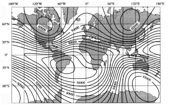

I was just looking at the following field map:
Figure 2. Total magnetic field presented in nanoTeslas
(please click on the image for the reference.)
And it looks as though we currently have two magnetic north poles, and one magnetic south pole.
Is this correct?
disclaimer: I am not a geophysicist, have never been one, and doubt I ever will be. But I do like playing with magnets.

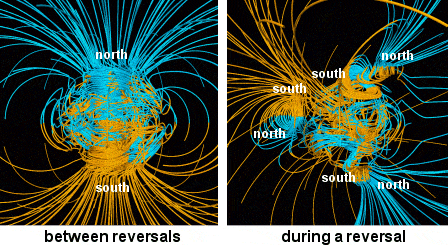

Evo said:
What the Earth's magnetic fields are supposed to look like during a reversal.
http://en.wikipedia.org/wiki/Geomagnetic_reversal#Character_of_transitions
A good article from NASA.
http://www.nasa.gov/vision/earth/lookingatearth/29dec_magneticfield.html
yeh i have seen these simulations, but had the problem they may have modeled presumptions.
