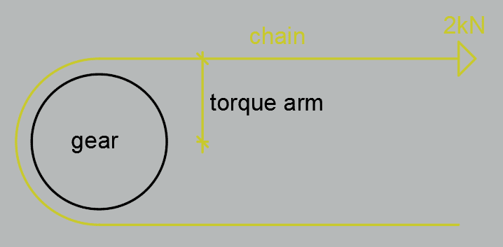

I was wondering how to calculate the RPM of a gear (or a wheel) applied with a known force. I'm guessing I'm not using the correct terminologies using Google, because I seem to not find exactly what I'm looking for.
Let's say you have some sort of pulley system or a bike gear for that matter. If one where to apply a constant force of f.ex 2kN to this pulley: what RPM will the gear have? It will of course be relative to the radius of the gear, which again will be important for the torque. So for the sake of calculating with numbers, let's say the gear is 1m across, making the radius 0.5m. So toques is 2kN x 0.5m = 1kNm.
But I can't seem to figure out how to calculate the RPM of the gear.
Anyone who can push me in the right direction?
You can't find how to calculate the RPM because there is no way to calculate the RPM here.
If the only torque on the gear is from a constant force on the chain, then the gear will keep on spinning faster and faster; the longer you watch it the faster the gear will turn, without limit. This is the situation you've described here.
Of course we never see gears behave this way, so we know we've left something out of the description. What is the friction in the shaft of the gear? That friction is acting to slow the gear down, and there is some RPM at which the torque from the friction will be enough to exactly cancel the torque from the chain; that will be the maximum RPM. But we can't calculate that until we know what the torque from the friction is as a function of the RPM, and you haven't included that in the problem.
@Nugatory has mentioned friction. That is the limiting factor in many cases. There is another limiting factor. That is the ability of the engine or bicyclist to supply a constant force when the chain velocity becomes very large.
Unlimited speed with a constant force requires unlimited power.

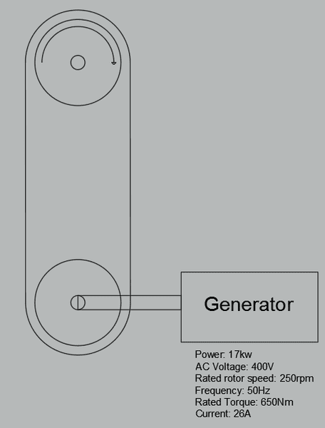

If we were to add a generator to the equation: Let's say that the permanent force on the chain is generated from a windturbine (knowing that the math to find the force on the blade to make it turn is simplified to a x-kN.) I just googled to find a generator with specs and came across something like: 20kw generator needs 250rpm and 650Nm to provide 26A. This would then be the resistance?
The pulley we played with earlier gave 1kNm with the gear being 1m across. Neglecting a need for a higher spike power to start the rotation; would the gear be able to provide the necessary RPM along with the torque? Now Torque and speed are some what of depended of each other. Higher torque in a bigger gear will give a slower RPM, and vica versa. So the equation I guess would either need more force to be able to meet the criteria or less resistance.
But how would you go along with finding RPM on a gear? Torque being the easier..
Or for the bike: we could have put a dynamo to the wheel, but I couldn't really find the information needed.
Still not enough information to answer that. You need to know the power output of the wind turbine.
Your diagram shows a force acting on a pulley. A force is not power. A book sitting on a shelf applies a force to the shelf without generating any power.
I think the formula
Power = Torque X Angular Velocity should be borne in mind.
It's the rotational equivalent of
Power = Force times Speed (in the direction of the force)
Real motors and engines have limits to their speed range and the optimum power and torque out can be at various different revs, depending on the technology.

Not finding any data on a cycle dynamo, I bumped it up to a generator. It could of course be a giant on a cycle, but let's say it is driven by water/wind/manpower.
Maybe I need to turn things around to be able to calculate what force is necessary to provide a given resistance (generator) with the given specs. My first toughs are that if the generator is supplied with 650Nm at 250rpm, it will generate electricity. Now, 250rpm is pretty fast so this will need to be geared down. But do I need to assume an rpm for the input (top gear) to be able to find the required torque/force? To half the rpm one would need to increse the torque by a factor of 2. A larger wind turbine usually operates at 12-15rpm, but with large torque due to the wings.
So I would think that rotation would indeed depend on resistance, but how would one go about finding the input force to make this configuration work?
If I were to assume rpm: let's say 30rpm, needed torque would be 250/30 = 12.5 reduction factor. 650Nm x 12.5 = 8.125kNm.
(now on thin ice) an applied force of 8.125kN 1.0m from the center of the gear (then being 2.0m across) would give the torque, but would it give 30rpm?
Or would I need to use Power = Torque X Angular Velocity to find the rpm?
Power been Watt
Torque Nm
and Angular Velocity ω (rad/s) converted to π x rpm/30
So for the generator Power (17kw) = 650Nm x π x 250/30 = 17kw, seems fair.
For the gear: 17kw = 8125Nm x π x rpm/30 => 20rpm?
Pretty sure I got something mixed up here...
Power been Watt
Torque Nm
That looks entirely correct.

Hmm.. been thinking about this for a couple of days:
If Power = Torque x Angular Velocity is "converted" to find RPM as I did above, that gives:
W = Nm x π x rpm/30
Solve for rpm gives:
rpm = W x 30 / (Nm x π)
In my mind (without overthinking) if one were to apply more torque, you should get more rpm (more force to the system). And reducing resistance should also give more rpm
But by the formula: More W (resistance?) gives more rmp, and more torque gives less rpm.
What I am I missing?
You have chosen to use the symbol "W" to represent power (in Watts). That's the rate of energy production per unit time. It is not "resistance".
Yes, if you apply more torque and, as a result, get more rpm then you will get more power output. But if you assume that the output power is fixed then you must also have changed out the generator design (e.g. used a higher gear ratio) so that the input RPM decreased in proportion to the input torque increase.
Ok, I think I understand. Thank you for the quick followup!
The principle (which is based on the conservation of energy) is that whatever power ##P## you produce at the input will be transferred at the output or:
$$P_{in} = P_{out}$$
Or, from the opposite point of view, if you determine that the output power you need is X watts, then you also need to produce X watts of power at the input.
So, if you need an output that produces 500 N.m of torque @ 100 rad/s, you know that this represents 50 kW of power. Therefore, your input source must produce 50 kW of power. But it doesn't have to be 500 N.m @ 100 rad/s, it could be, say, 50 N.m @ 1000 rad/s or 1000 N.m @ 50 rad/s. It doesn't even have to be mechanical, it could be an electrical source that produces 208 A @ 240 V, which is also 50 kW.
So identify clearly the power requirement of your system (more torque = more power; more rpm = more power). Then, you know that whatever power gets out, it must comes in somehow.
What Jack says is true, assuming 100% conversion efficiency which is itself never true. What he says is a good place to start, but you will have to allow for losses if you want to have realistic results.
Thank you jack for the clarifying answer. From what I have read this is how windturbines work (in general): large amount of torque, slow rpm => geared down to fast rpm for a smaller generator. And of course Dr.D there are losses in a system, in all connections and gears and drag...
Thank you for all of the answers!
