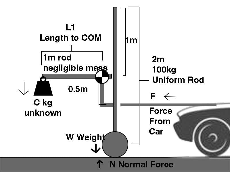

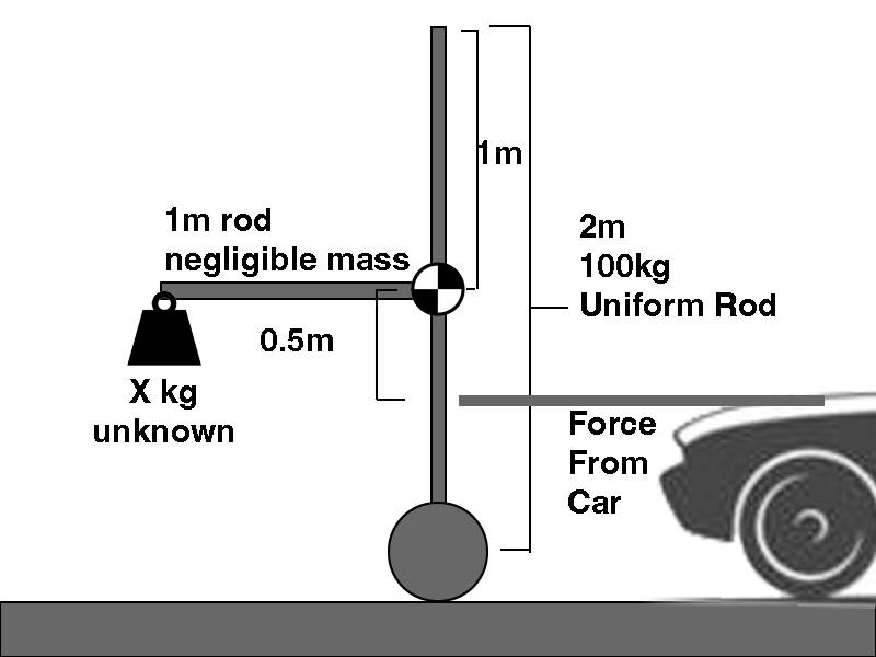

I have tried to draw a force diagram to illustrate the problem. Suppose I have a 2m, 100kg uniform rod with wheels at the bottom. Center of mass is middle of rod. I want to accelerate this rod horizontally while it remains perfectly vertical (constant angle). But the force is coming from a rod on a car, and this rod is pushing horizontally 0.5m below the center of mass of the rod. To keep the 2m rod vertical, the moment thrust is applied I attach a 1 meter rod projecting horizontally from the front of the 2 meter rod, this rod is of negligible mass but has a weight at the end. How would I calculate the mass of the weight at the end for 1m/s^2 constant horizontal acceleration at constant angle vs 2m/s^2 constant horizontal acceleration at constant angle? Am I missing any variables?
You mark the centre of mass of the rod, but do not specify the mass of the wheels at the bottom of the rod. That will move the CofM of the vertical rod.
Is the vertical rod attached to the car, or only pushed?
The push force applied by the car will accelerate the total mass linearly forward, without rotation.
F = mt * a ; where mt is the total mass, including the forward mass.
That force will cause a torque F * 0.5 clockwise.
You need a front counter-weight, mc, to provide an F/2 counter torque.
That comes from; F/2 = mc * g * 0.5
mc * g * 0.5 = F/2
mc * g = F
mc = F / g
mc = a * mt / g

Is my explanation correct:
Since the counterweight is twice the distance from center of mass as the point of application of the force from the car, the force from the counterweight should be half the force from the car to prevent rotation.
Running some numbers, I get:
-with a force from car of 100 newtons, the counterweight mass is 5.1kg, total mass 105.1kg, acceleration .951m/s^2.
-with a force from car of 200 newtons, the counterweight mass is 10.2kg, total mass 110.2kg, acceleration 1.81m/s^2

Here are the equations and forces I used:
(100 Newton/2)/9.8 = 5.1 Counterweight Mass KG
Counterweight Mass 5.1 KG + Rod Mass 100 KG = Total Mass 105.1kg
Acceleration 0.951 m/s^2 = 100N / 105.1KG
I will draw a better diagram sometime next 24 hrs.
One point I'm confused by... say we want to target a specific acceleration, say 1m/s^2, I can't figure out how to do this. It seems to calculate the force for 1m/s^2 acceleration we need to know the final mass including counterweight, but to know the mass including the counterweight we need to know the force.
Yes, that is correct, but that is how you specified the problem. All I did was to solve for your question, then I realised there was a special case solution.
There is an obvious acceleration limit with the fixed torque-arm lengths specified. For accelerations greater than g, the counterweight must weigh more than the total, which is slightly impossible, like having zero mass wheels, or zero rolling friction.
If the counterweight mass, mc, was specified, the length of the forward arm could be computed for any acceleration, and the acceleration limit would disappear from the solution. It is easier to slide a counterweight along a rod, than it is to adjust the mass of the counterweight.

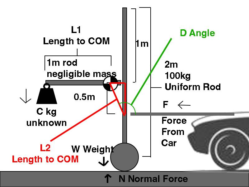

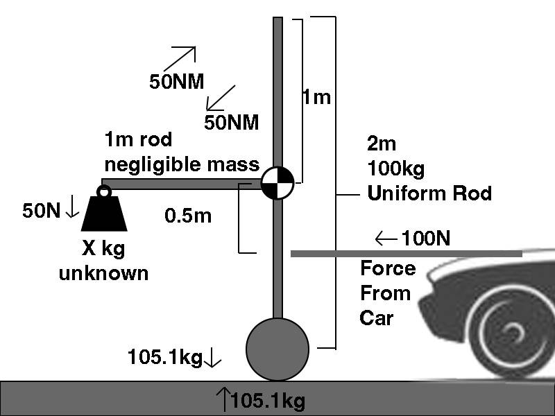

I was going to draw it like this but I have some doubts, as it would appear the center of mass moves when the front counterweight is attached.
What do the diagonal 50Nm vectors in the upper left represent? Why are there two of them?
One is a 50 newton meter torque around the center of mass from the car, the other is a 50 newton meter torque in the opposite direction from the counterweight.
Okay, that's not how a traditional FBD is labeled, but I understand that you are new to that concept. In your FBD you should normally just show the forces and where they act on the structure. Then you write an equation to sum the forces on the structure and a separate equation to sum the torques (moments) on the structure about some point. If the structure is not moving (translating or rotating), then both of those sum equations are equal to zero. If the structure is translating or rotating, the sum of those forces or moments can result in a net acceleration (linear or angular).
Can you draw a simplified FBD now that shows the forces on the structure? And can you then write those two equations? :smile:

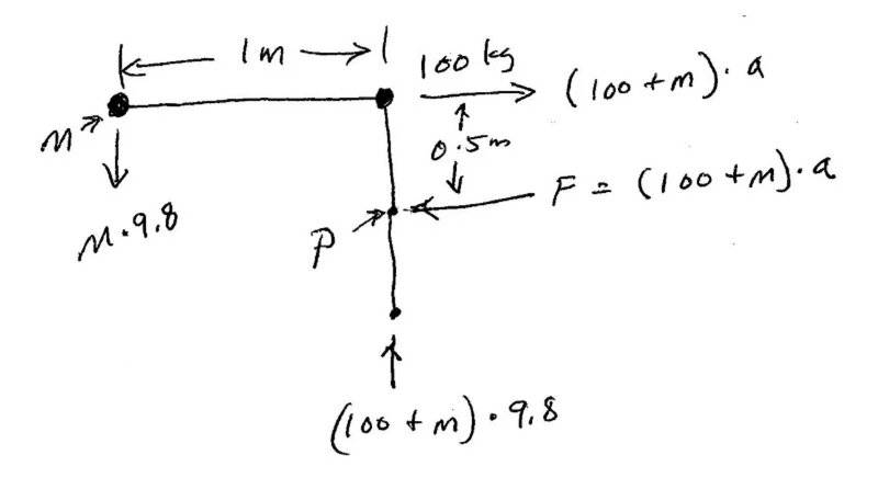

Sorry it took so long, been busy with work. Here's what I've got so far:

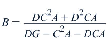

I also found this equation to help in determining L1:
Source: http://hyperphysics.phy-astr.gsu.edu/hbase/cm.html
Also I can use Pythagorean theorem C=sqrt(a^2+b^2) to determine the length of L2.

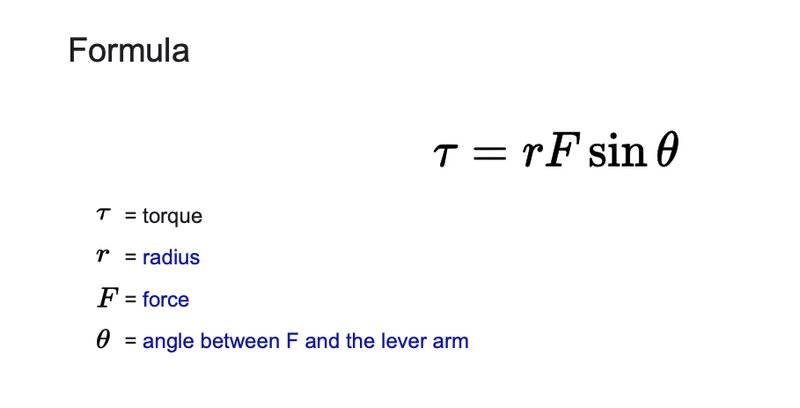

For the torque from the car and counterweight, I believe I can use this formula:
How accurate do you want to be? With a torque of 50 NM without the weight, you only need about a 5.1 kg weight to counter that torque in this setup. For a 2 m/s^2 acceleration that doubles to 10.2 kg. Whatever else may happen when the center of mass moves, those numbers should be pretty close to what you need.

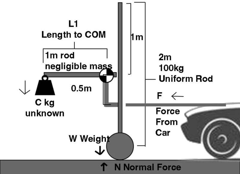

If we attach a bracket of negligible mass as shown, we can eliminate angle D and L2 from the previous force diagram, but we still need to determine L1:
