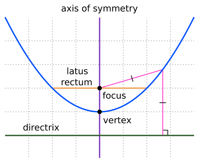

Why do you consider the focus is at (0,9)? The top of a parabolic archway is not the focus of the parabola.

This image labels the key points of a parabola which opens upward.
You'll have to imagine the figure is flipped upside down to match the archway in this problem.
What you are calling the focus of the parabola is actually the vertex. Usually, the focal point cannot easily be identified by inspection like the vertex can be.
https://en.wikipedia.org/wiki/Parabola

Since you know two points on the x-axis where the value of the parabola's equation is zero, you can use these coordinates to re-construct the equation of the parabola, even if you don't know the location of the focal point.

I don't think you can make this claim that p is negative.
p is the distance from the vertex to the focus of the parabola, and p is also the distance from the vertex to the directrix. The focus and the directrix lie on opposite sides of the vertex, regardless of whether the parabola opens upward or downward.

The calculation of p looks OK, but you should write out the equation of the parabola. I prefer y = something.

The problem statement wants you to find the height of the arch at a location 1 foot in from the base, i.e. where the arch intersects the ground.
You've already found the equation of the arch, so this task is not an additional condition to impose on the shape of the arch, merely an exercise to use your previous work and find out some additional information about the arch, given its equation.
