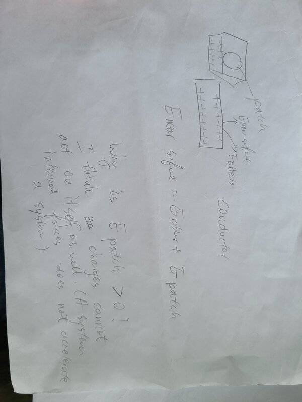

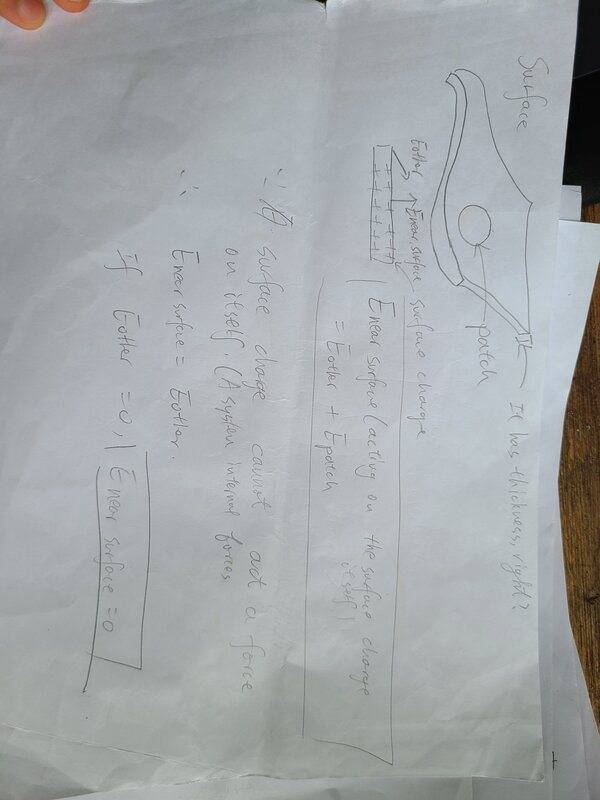

I have included two pictures above to illustrate my reasoning.
Actually I don't know what the difference between a conductor and a surface is. In my imagination, a surface is merely a thin conductor, in which the upper surface and lower surface is filled with charges. What makes it special for conductor not to have a zero E patch force on itself? If you are pleased, it is very good to draw a diagram to illustrate the things you are talking about.
Sorry I really feel that I am stupid!

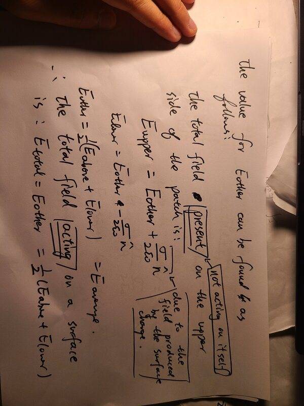

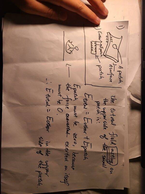

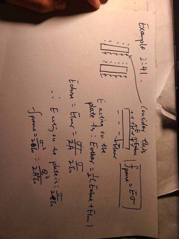

After thoroughly reading Griffith's book, word by word, carefully, I have reached this understanding which I find satisfactory. I am able to solve the two follow up questions on Griffith's book.
This is one of the questions I have done. The question is about finding the electrostatic pressure on the metal plates, each of which is charged with Q and has an area A.
@Tony Hau two things:
First, your pictures show up sideways, not right side up. That makes them very hard to read.
Second, please use the PF LaTeX support to post equations, and post text as ordinary text. Images should only be used for actual drawings--things that cannot be posted in one of those two ways. If you need help with the PF LaTeX features, there is a "LaTeX Guide" link at the lower left of the edit box that is used for posts.

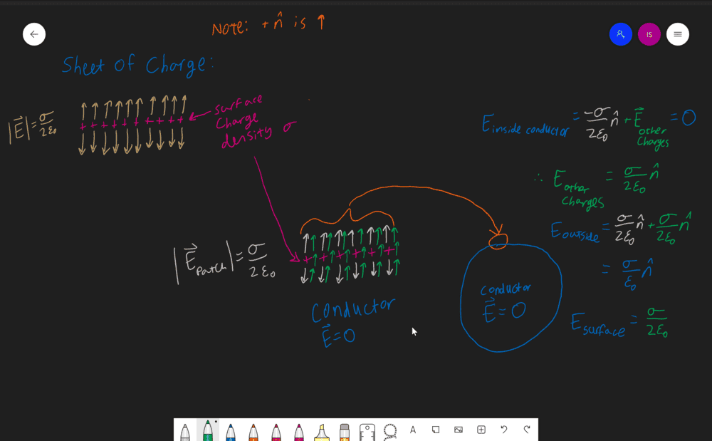

Something seems a little off with those pictures, so I figured I would add a picture with my work for this. Note that the only reason I am including equations in the picture is so that they are color-coded, so that you can match the terms to the vector on the diagram:
Notice that for the sheet of charge, there is no electric field AT the surface-- unless there is some external electric field that I did not draw, in which case the field at the surface would just be that external field. For an isolated conductor, there must be an electric field caused by the other charges in the conductor (i.e. on the other sides) that makes it so the field inside the conductor is zero (note that my diagram shows what is happening immediately above and below the surface, so the field caused by the other charges is constant). You'll notice that there is no field caused by the patch (the silver vectors) right at the surface-- thus the electric field at the surface is only the (green) field caused by the other charges in the conductor.
For me, the field lines help me understand it better-- I know it may not be the same for everyone.

A surface has zero depth, by definition. A charge layer is assumed to have zero depth because the charges (electrons and ions) are assumed to be points.
You can have surface charge on the sides of any conductor.
