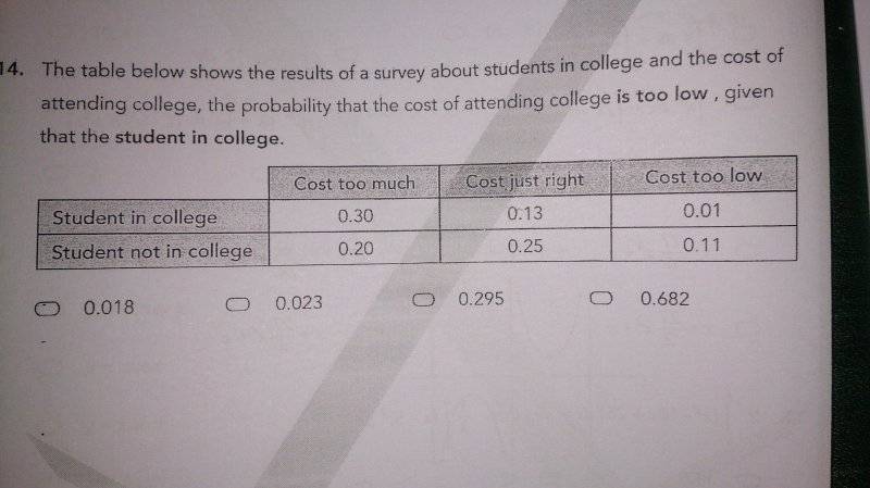

Q2)

Q2) couldn't understand the question or solve it :(

For (2): do you know what conditional probabililties are? You are being asked to calculate the probability that the cost is too low, given the person is in college.
Question (2) is poorly worded and very ungrammatical, and whoever wrote it should be ashamed of themselves. Also, the question does not make sense to me in practical terms: it is asking about the group of students who say "I am not paying enough for my college education".

And I completely support RV on Q2 - the table is not well-described and there isn't even a question or a directive action verb like "State" or "Calculate". Here's my quick interpretation of what the text should say:
A survey was undertaken asking current and former students their opinion on the costs of attending college. The table below presents the proportion of respondents who answered in each of three possible categories, also split by whether they were in college presently or not.
Calculate the probability that a student in college would give the response that the cost of attending college is too low.
