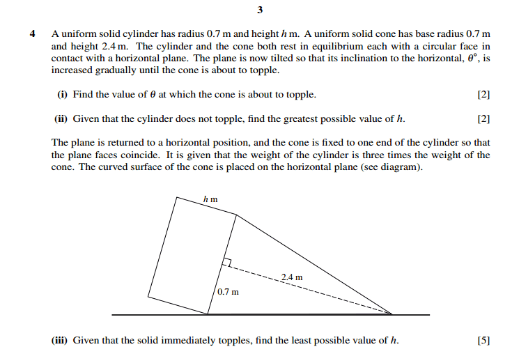

What is the required h for equilibrium in a body with two center of masses?

problem attached
i had no problem with part i and ii , iii on the other hand, i simply don't know what i should do , i figured out that the required h will be the one making the center of mass of the whole body on the vertical from the point it's standing on ( moments from both center of masses will be equal )
but i have no idea how to get that

Axe199: It is just geometry and trigonometry, and the moment summation you mentioned in post 1 ... and algebra. And arithmetic. Just start by drawing and labeling the trigonometry; any and everything you know. Eventually, you will build relationships, and be able to write expressions. Just start, and try something. If you do not try something, and do not make a valid attempt, then we cannot check your math and give you hints on where you went wrong.
