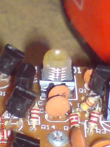

What is this ( the yellow colour one ) ?
  • Close-up of a printed circuit board showing an amber-coloured LED mounted on the board, with labels Q1, R1, R3, R14 and C printed nearby and orange and black components around it.
If you're talking about the one at the end of the board, it looks like either an inductor (see the response in one of the other threads by this same name) or coil antenna. They're encased in hot glue or silicone to make them a little more robust and give a little bit of environmental protection (depending on what you want to use them for).
If its an inductor then it should pass the continuty test.
Looks like an inductor but a low value one. You can see the wire coil(?). Is there a screw adjuster in the centre of the cylinder? Is there a "H" printed on it to show its inductance or is there an "L" printed on the board, like the Rs and Cs? It looks like a small inductance which is odd, considering the surrounding components and their layout, which suggests lowish frequency of operation. It could be a transformer - how many connections are there? IS there a "T" on the board?
MATLAB's suggestion is also possible.
Does the board work? What does it do?
There are more questions than answers, I'm afraid but I hope they help.

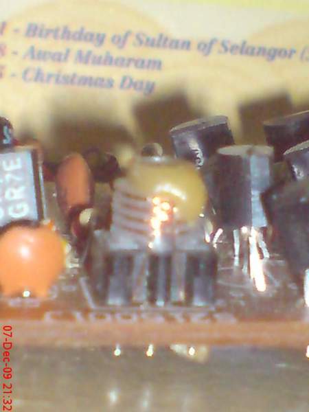

Wat is this ? (yellow )
  • Close-up photo of a circuit board showing a yellow dome-shaped component with a metal case and three leads, beside orange capacitors and black transistors, with a calendar page behind.
It looks like an inductor with a lump of glue on it.
This is done to make it immune to vibration.
What circuit it is? It might help understand the device.
I guess it to be some radio circuit because of large number of discrete components and small capacitors. The said component might be a transformer or an inductor and a capacitor togather.
