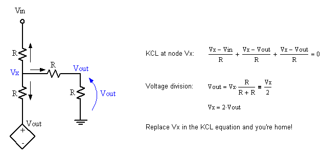

What is this unique op-amp's name and how do I find Vout?

As for the Vout question... perhaps you should make a KVL loop including Vin and Vout?
Or just apply Ohm's law using the difference in voltages?

But how can I apply loop to an OPEN circuit? I need a beginning and I need an end. Hmm. Oh, I get to call the end Vout, eh?
http://img444.imageshack.us/img444/6113/taktak.jpg
But I'm not sure how do I know that I1 = I2. My teacher told me that, but all i know is that
Sigma I = 0 ; It -I1 -I2 = 0
But that doesn't tell me I1 = I2

Yeah, actually I1 = -I2, since you drew the arrows in opposite directions, but their magnitudes are the same.
The key thing is that the op-amp does not draw current.

In your 2nd picture you connected the left leg (b) to the ground.
It's not connected to the ground but to a "controlled" voltage source giving off a voltage of Vout.
In other words, your Sum V(b) is not right.
It should include Vout.

Oh, it can be solved using only KCL and KVL, and I recommend doing so if only as a verification.
In your 1st method you made a calculation mistake (which you can find by verifying with the 2nd method).
In your KCL/KVL method you didn't use a proper loop.

Let's see, first you go up from Earth to 2 [V].
We're at V- now aren't we?
Then you follow resistor R1 down, which is good...
And then we're at Earth again.
All finished! :smile:
... except that you moved on to R2, and then Vout...
But how did you get there? :confused:
  • #46
  • #47
Femme_physics said:
Because there are 2 ways to get to the ground. Yours is easier, admittedly, but I don't see Vout in your equation?
Okay, let's do this again and follow a different path.
First 2 [V] up from Earth to V-.
Then we follow R2 down (instead of R1).
Then we go down with Vout.
... and we're back at the ground!
Now we have 2 loops...
Can you solve them?

Your equations are good! :smile:
But... your solution isn't! :frown:
If you substitute your solution in the first equation for V(a), you'll see it doesn't fit.

Ok,
I got now,
I1 = 0.6 mA
I2 = 0.3 mA
I3 = 0.3 mA
Vout = I3R4 = 0.0003 x 5000 = 1.5 [V]

That's because the current doesn't split.
Any reason you think it does?

And I1=-I2 because of KCL.
(Note the minus sign.)

Yeppers! :)
It's a divide-by-4 circuit!

Oh, wait, so 2 currents "emerge" from Vx?
Umm... no...
You chose to draw 2 arrows as if the current "emerges".
But it doesn't.
So one of the currents has to be negative.

I just thought I might offer the following thought regarding analyzing these sorts of circuits. It often turns out that Nodal Analysis (KCL) is the most expedient way to handle op-amp circuits. This is because the nature of the op-amp often fixes voltages at certain nodes or eliminates certain currents right off the bat. It simplifies things considerably when some of the "variables" are taken care of like that.
In the case of our mystery divide by four circuit, KCL at node Vx can make short work of things:
Thanks gneill! I will print it.
