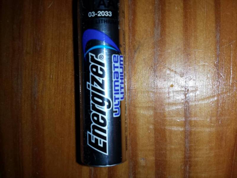

I'm thinking about buying a tp4056 and I'm wondering what thermistor I should buy. I looked at the data sheet and it said a [STRIKE]new[/STRIKE] NTC but that was it. So I went online to find one and I noticed they have resistance and I don't know which one to get. Could someone help me figure this out?
When I said new I meant ntc.

I don't think we are talking about the same battery. What battery are you talking about?
show us a pic of YOUR battery and also a datasheet for it would help too

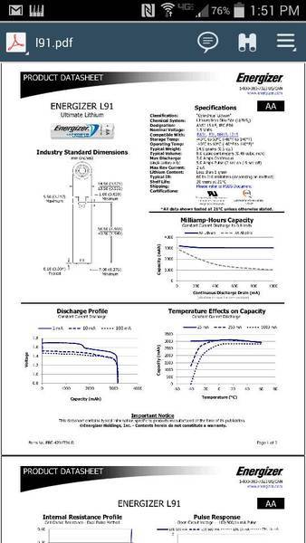

Datasheet for the battery?
Yes. Or at least a picture of the contacts.
There's the battery and datasheet

I see, now. We have been at cross purposes. I (/we) were assuming that you were talking of the type of LiIon battery pack you get in cameras, mobile radios etc.. These are in a (8V or whatever) pack with their own protection circuitry included and sometimes have several contacts on the sealed pack which interface with the 'special' charger. They usually cut off when the volts get low and cannot be recharged without opening the case or getting at them in some way.
Energiser (the company) supply their own chargers which will be their own design and may or may not include your charger IC. The value of the thermistor will probably be difficult to find out without opening up an Energiser charger and trying to read the legend on the side of the thermistor (probably some obscure number) and the IC may well have a similarly unhelpful type marking on it. They probably don't want you to copy their unit.

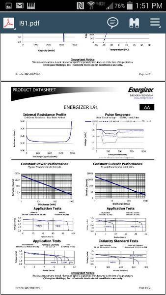

The Energizer literature for "Energizer Ultimate Lithium" L91 batteries says in two different places that they are not designed to be recharged.
Is that the battery you propose to recharge? It's the one for which you posted datasheet.
Product safety sheet here
http://data.energizer.com/PDFs/lithiumirondisulfide_psds.pdf page 2 of 4
Charging:
This battery is manufactured in a charged state. It is not designed for recharging. Recharging can cause battery leakage or, in some cases, high pressure rupture.

Batteries connected in parallel should be at the same state of discharge. If batteries at different states of discharge are installed into a device using a parallel battery configuration, the battery with the higher voltage will charge the battery with lower voltage until voltage equilibrium is reached in the system. This charging could lead to leakage, elevated temperature, or other damage to the lower voltage cell.
What you propose is risky business . I think you should buy rechargeable batteries instead.
