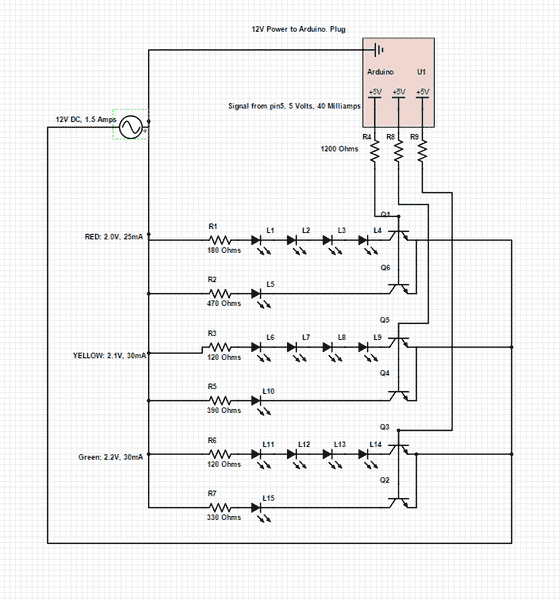

So I want my wire that is at the end of the LEDs to go into the Collector part of the Transistor. Base to the Arduino, and the Emitter to Negative?
Virtual Example(Drawings of circuits really help me):
Is this how it is supposed to work? The arduino just completes the circuit, correct?

HAP...Thank you for taking a few minutes to review ( so many people that come here for answers -- well just want answers!) Yes your sketch is what we need as a concept. -- I have not done the math...
As a good practice the 12V and the arduino should share the same GND or Negative Bus - in this schema these details are not shown...
  • #34
OK back - from my sketch pad... 4 x 2.2 V + 0.2V ( transistor) = 9V... 12 V supply... the difference is ? ... 3 V ... series ckt is 30 mA ..
3 V and 30 mA --- what is the necessary resitance to drop that V?...
Then use the I^2 * R or V*I to get W, and that is the resistance and size (wattage) of the resistor you are looking for... now repeat for the other colors...

Thanks for this. And yes, I am looking to learn how to do this on my own, instead of coming here every time I need an answer to something.
So when you were calculating the transistor, you used: (Vf * ledcount) + 0.2V = 9V
What exactly is this meaning? Why do you add the 0.2V?
So then when there is 3V and 30 mA left over, you add a resistor just to drop the voltage to completely 0? (3*30 = 90) This would mean I would put a 100Ω(Closest to 90 rounding up) to the negative then to ground or negative?
Note: Power source in diagram is meant to be DC, not AC

Only one resistor. It's R1 that soaks up the spare voltage (and in the process sets the circuit current). Don't put a resistor where you show R2.
  • #37
Other than that, it is fine? What about the output of the arduino. Should I limit the milliamps or voltage going into the transistor? And does the voltage going into the base affect the current/voltage going through.

Oh, I see what you were up to. Yes, you'll probably need a resistor in series with the base to limit the current from the Arduino. So you had just shown it in the wrong place. How many volts will the port deliver for output HIGH? Anyway, choose R to limit the base current to about 3 or 4mA.
What is the maximum current the Arduino port can supply?

Are you definitely going to power the Arduino board from the same voltage source as the LED array? If so, as well as connecting the +12V to the Arduino, you need to connect the 0V of the supply to the 0V of the Arduino board. It might be labelled GND or (-).

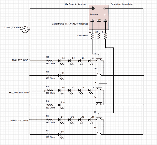

Updated diagram with 3 colors of LEDs and correct resistors:
Does everything look right? I'm going to double check the calculations right now to make sure everything is right.

The power to the board is a 2.1mm plug. That is why I question you plugging everything into the boards ground. The boards ground is usually only used if you use the boards 5V power pins.
And thanks for the warning!
  • #51
You can connect the LED board directly to the +12 and 0V terminals of the supply, and connect the Arduino's plug to the two terminals of the supply also.
  • #52
Confused. Like this?
  • #53
Two wires from the 12VDC supply have to go to the Arduino. You show only one, and it's +12V so should not be going to GND.
Separate question: you show something going to pin 5 of the board. You need the base resistors to each connect to a different pin on the board. Do you have this sorted? You seem to have the base resistors going to a constant +5V on the board---this would keep the LEDs lit all the time, not under software control.

That one line includes a positive and negative. It's kinda confusing, I cannot seem to split the line.
Oh yes, I just forgot to remove that. Each "+5" sign resembles another pin used. In this case, I am using 3, one for each color.

Kudos for your diagrams - they are the language of electronics! ( Edit - not that they are perfect or follow the best practices(still good) , but that you took the time to do them with a proper schematic tool...)
Now how does it turn on and off:)
