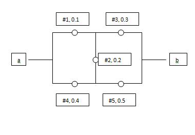

I have done problems similar to this one with 4 components but I am getting stumped with this one.
The probability of failure for each components is next to the number
i basically need to find the probability that the system works..but the 5th component is confusing me
so far I have system fails= (A1UA4)UA2U(A3UA5), then you can just subtract 1 to get success
im wondering how to set up prob of success using intersections and unions.. and a method to find this so i don't have to post everytime i have a question :p
I get 1(3 + 25) + 4(5 + 23), using + for "or" and concatenation for "and". Your answer, (1 + 4) + 2 + (3 + 5) -- was that trying to be 14 + 2 + 35? -- disagrees with mine.
well i think there is also another way to do this problem.
B can represent the entire system.
P(B)= P(A2)*P(B|A2)+P(A2')*P(B|A2') where | means given and ' means not
so if that's true how would i calculate the probabilities?

This statement is true but won't let you compute probabilities.
It's not clear to me what is required for the system to work. Is it supposed to be redundant? Will any operative path from a to b be sufficient for the system to work? It appears component two not redundant so it looks like two possible directed paths from a to b. Note the probability of system failure is the highest single component probability of failure on a critical path.
ways for the system to work are either of the following:
1-3, 4-5, 1-2-5, 4-2-3

OK. Then path 1,3 has the lowest maximum single component failure rating with component three having P(F)=.03. If component one fails, that's still within the 3% failure expectation. It doesn't matter if they both fail. So P(S)=0.97.
However, from your original equation, it looks like component 2 is not redundant. That's a more interesting problem. What would P(S) be in that case?
well 2 is there if 3 AND 4 fails. 0.97 seems like a likely probability though...

Yes, if component two can be bypassed. But we just don't give answers here. If you understand the problem, you should be able to compute P(S) if 2 can't be bypassed. It's not hard.

that makes a lot more sense now. now one hard question I am trying to figure out from that is the probability that component 2 works if the system works. so does this mean you have to go through component 2?
megr_ftw;2926883]that makes a lot more sense now. now one hard question I am trying to figure out from that is the probability that component 2 works if the system works. so does this mean you have to go through component 2?
The system can work, the way you set up, if 2 fails. Only operative paths then are the 4,5 and the 1-3. I would run the 4,5 until failure with the 1-3 backup. That way you have no more than 3% expected failure. The paths through component 2 have maximum single component fail rates of 4% and 5%, so it's nice to have, but the system can function without them. To know if component 2 is working you have to shut down 4,6 and 1,3.
The the probability of success if you force the paths through component 2 would be what?
EDIT: Forget what I said if your running all paths at once. Then you do use joint probabilities as long as there are no failures or you're not forcing certain paths over others. So if 1,3 and 4,5 are both open, P(S) is 99.85%. For testing component 2 your joint probability of failure is (.04)(.05) P(S)=99.8%.
probability of success is .998 correct?
so if component 2 works if system works the prob. would increase right?

There are combinations of component failures that will require component 2 to function. When this happens, system P(S) will drop. I typed an analysis of these but it disappeared. Possibly it was deleted because I was helping you too much. Find the combinations of component failure that force component 2 to function as a necessary component for system function and determine P(S) based on maximum single component failure rating.
well to get it straight i got .801 for probability of success...
How did you get that?
i converted everything to prob. of success for each component first
(A1^A3)U(A4^A5)U(A1^A2^A5^A3'^A4')U(A4^A2^A3^A1'^A5') where ^ is intersect and ' is NOT, or failure...
(.9*.7-.63*.3)+(.9*.8*.5*.3*.4)+(.6*.8*.7*.1*.5)=0.801
this is probability a long way to do this but the only way i know how

I think you've missed the whole concept of maximum single component failure rating for a given path. The failure rating for a given path is just the maximum failure rating for a pass-through component on that path.
well crap... i know there are only 4 paths it could take so using that notion i did that calculation

ive been work on this for a while and for the probability that component 2 works given the system works I got 0.76.
and for the probability that component 3 works given the system works I got 0.604...
anyone want to check that because i followed my notes from my teacher and applied them the way i think using conditional probability
