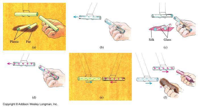

Early experiments with rubbing glass etc. with fur etc. ( you know the sort of thing) found that some combinations of charged objects attracted and other combinations repelled. The results were looked at and it was concluded that there must be only two kinds of electric charge. They could have been called anything - Red and Blue, George and Harry but the Maths involved when using just 'names' would have made life very hard. It was decided that the charges could best be described by a value (how much charge or how much force etc) and a sign. The choice of which sign to choose for a charged glass rod or a charged piece of amber or from one particular terminal on an early chemical battery was quite (afaik) arbitrary. This was way before they discovered charged sub-atomic particles like electrons and protons. When the electron was discovered and its charge measured, it came out as -1.6021766208(98)×10−19coulombs - and they're all the same.
This negative value of the electronic charge is absolutely fine (really!) but it does confuse and upset students because the flow of electricity in metals (and most other things) consists of electrons (negative charges) flowing from the Negative Terminal to the Positive Terminal.
