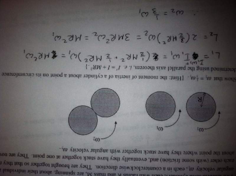

I'm working through a practice test my professor has given us. The question is as follows:
Two uniform solid cylinders, each with radius R and mass M are spinning about their individual axes, with angular velocity w1, each in a counterclockwise direction. They are brought together so they rub against each other and eventually they have stuck together at one point. They are now rotating about the point where they have stuck together with angular velocity w2.
We are supposed to show that w2= 1/3 w1
His work looks like this:
L1 = I1w1 + I1w1 = (1/2 MR^2 + 1/2 MR^2)w1 = MR^2 w1
L2 = 2 (3/2 MR^2) w2 = 3MR^2W2
My question is where is he getting L2 from? Where is 3/2 coming from, why is he multiplying by two, and is there an easier or more intuitive way of solving this problem other than his solution?
Looks like an application of the Parallel Axis theorem. Where's the new axis of rotation for each cylinder with respect to their originals?
They've stuck together and are spinning like that.
I don't get how he's using the parallel axis theorem to get any of that.
I can se how maybe I1w1 + I1w1 = I2W2, because momentum is conserved, but where does parallel axis fit in there?
Attached is the picture.
Well, what's the moment of inertia of a cylinder (or disk) rotating about a point on its rim?

skysunsand said:
I = 1/2 Mr^2.
No, that's its moment of inertia about its central axis. You want to move the rotation axis to the cylinders surface.
Then wouldn't it just be MR^2, because then it's a point mass?

No. You use the parallel axis theorem to determine the moment of inertia of a cylinder rotating about an axis that is not its central axis. You only apply it to the expressions that concern the cylinders that are rotating about such an axis. Initially both are rotating about their individual central axes so you don't apply it there.
When the cylinders "stick" their new axis is parallel to the old ones but at the surface of the cylinders. Both cylinders rotate mutually about this new axis. Both will have moments of inertia about this new rotation axis that can be calculated using the Parallel Axis theorem. Find that moment of inertia. Sum them (there are two cylinders).
Conservation of angular momentum applies. Use it to determine the new rotation rate for the pair.
So that's where he gets L1- each of them are turning by themselves, so they're just
(1/2 MR^2 + 1/2 MR^2)w1.
But then okay, the second one is where you have to put them into parallel axis.
I= I + MR^2 is the equation for parallel axis. All I understand is that maybe you still put 1/2 MR^2 into one of those I's to get
I = 1/2MR^2 + MR^2
Which is where he got 3/2 MR^2!
And then, because it's more than one cylinder, it has to be multiplied by two. And then W2 gets tossed in there to prove w2 = 1/3 w1.
