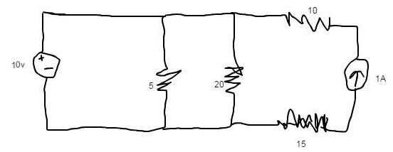

Circuit schematic with a 10 V voltage source on the left feeding three parallel branches labelled 5, 20 and 10 ohms, with 15 ohm resistor and a 1 A current source on the right.
Find the resistor that generates most heat.
Principle of superposition.
Voltage Div
Current Div.
Power = I^2R
After aplying principle of super position and considering the voltage source in one scenario with current source open circuited and calculating current for each resistor and then short circuiting the voltage source and then again calculating each current. After that I added all currents for each individual resistor and caclulated the power output of each individual resistor by I^2R. The highest wattage I got was for the 5 ohm resistor (48.05W). So I concluded that the 5ohm resistor produces most heat. Is this correct? I have no solutions for this.
I wonder how you can get so much current through this 5##\Omega## resistor. I do agree it's the one that generates the most heat,

Off the cuff, that doesn't sound like the right thing to do, but then that's probably because I'm not used to using that technique. I just do loop analysis and find all the voltages and currents with both sources active. If your calculations are right then you should have the right answer.
I don't understand the contradiction in your two statements, one of which gives an answer and the other of which says you don't have an answer.
Sorry. I meant to say that I have no given solutions for this. The 5 ohm answer is my solution. My fault there
Ah. Thanks for that clarification. That makes sense. With just a quick look, and no calculations, I'd say your answer is right.
EDIT: well, that's embarrassing. I should have seen immediately that you don't even have to DO an calculations (that is, no circuit analysis). The power of each resistor is obvious at a glance and yes, the 5 ohm is the largest. Do you see why I say that? That is, do you see why I say no circuit analysis is required (mesh, loop, or any other kind).

Then perhaps recall p=v^2/r or p=i^2r you don't need to calculate both I and v for each resistor (although you could).
Yes, that's true. How does it apply to the question at hand?
For much the same reason gneil said in #7..
If you have a resistor in parallel with a voltage source the voltage is known and it's a no-brainer to use p=v2/r. (eg on the 5R and 20R)
If you have a resistor in series with a current source the current is known and it's a no-brainer to use p=I2r (eg on the 10R and 15R)

Seems to me that minimum calculation is what is being looked for here. We have the same current going through two resistors so using I2R it cannot be the 10 Ω on that generates the most heat, it might be the 15 Ω one.
Loking at the parallel branches what is their joint conductivity? It's 1/5 + 1/20 = 5/20 = 1/4 Ω-1. So the total conductivity of this parallel branch is more by a large margin than that of the 1/15 Ω-1 conductor in series with them so the latter is still the one that heats the most. There is a higher resistance (20 Ω) in there but not so much current goes through it. This however is not all that obvious just looking at it, I mean it is obvious it could be that way but not obvious that it must be, could it be different with different resistances? - so I am wondering if there is not a still more powerful approach to this with maximum power principle or something.

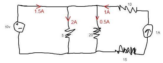

Circuit schematic with a 10 V voltage source on the left and a 1 A current source on the right, with resistors labelled 5, 10, 15 and 20 ohms and branch currents 1.5A, 2A, 0.5A and 1A marked in red.

CWatters said:
Yes you can.View attachment 90154

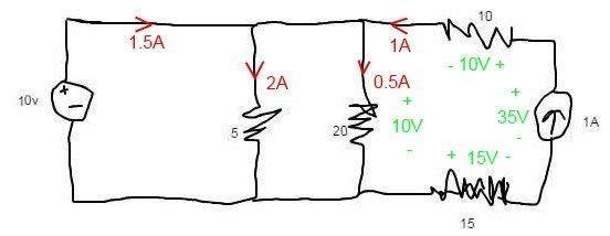

The reason I thought them incompatible and still do not understand how they can be compatible is that if 1 A flows in the right hand branch there is a total voltage drop of 25 V over the 25 Ω resistance between the points where it joins the rest of the circuit whereas looking at the left had side the voltage drop between the same points is supposed to be 10 V. Can you explain this?
There are four elements in the right hand loop (three resistors and a current source). The voltage drop and polarity across three are known and, as you say, they add up to +25V (assuming clockwise is +ve).
Apply KVL to work out the voltage across the current source.

The voltage drop and polarity across three are known and they add up to +35V (assuming clockwise is +ve).
:)) I am definitely the learner now. I had a slight worry from start maybe I don't understand the nature of that current generator. Then I thought well they show 1A which it supplies regardless, whether you attribute it to the wire or to the generator device makes no difference, and I thought it was like ideal voltage generator, you just ignore its internals, it has no resistance. Now I've read around it a little and on the contrary it has infinite resistance. Let's say very large resistance, I don't need idealisation explaining. And also (they seem more reluctant to say) very large voltage. And there is a voltage drop across the current generator, I hadn't grasped that.
And it seems everything can adapt to the parameters of an external circuit. However not yet seen that very well explained. Coming to your KVL the voltage drop for 1 A flowing in the 15 the 10 Ω resistors is 25 V. To match the 10V doesn't drop across the current source then have to be -15 V and considering the direction of current flow the resistance have to be negative? :oldsurprised:

read post #7. an ideal current source will produce ANY voltage to provide its current. If that means it produces -15 volts, then so be it! looks like this current source has a negative impedance in this case!

OK fine, that settles everything for now. I'd thought OK why not, but in web page after page I'd not seen it mentioned. But that must be because they all talk about a simple single load?

If you mark up the drawing correctly and apply KVL you should get an equation like this..
+15 + 10 + 10 + ? = 0
where ? is the voltage across the current source. It's not going to be -15V.
