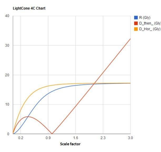

Jorrie posted some charts that are very nice in the other thread earlier today. I'm going to try and duplicate one as an example. The red curve shows the shape of the past (plum-shaped) lightcone and the future (funnel-shaped) lightcone. The present (of course :smile:) is where the stem of the plum joins the neck of the funnel.
The space between the Hubble radius (blue curve) and the event Horizon (gold curve) is the margin where the universe allows sources receding faster than light to send messages that will eventually reach us.
Since in this case scalefactor is serving as "time", the present comes where it equals 1.
The point where the the red curve past lightcone intersects the Hubble radius (blue) shows where a galaxy emitted light that initially "stood still" making no progress in our direction because its forward motion thru space was exactly canceled by the rate the distance to target was increasing. I guess everybody here is familiar with that observation but mention it just in case it might be a new reflection for someone. This happens right at scalefactor 1/2.6 whatever that is, probably just slightly less than 0.4.
Yeah, 38.5%, just a bit under 40%. That is the unique epoch in history when galaxies on our past lightcone were sending us light that "didn't get anywhere" at first. And it is where the past lightcone has its largest radius, namely properdistance 5.8 billion lightyears. So nice to see these familiar facts depicted on a chart!
