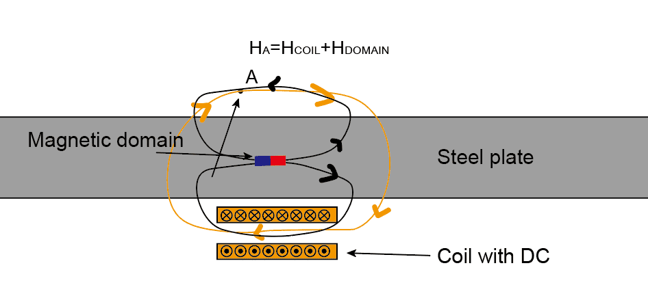

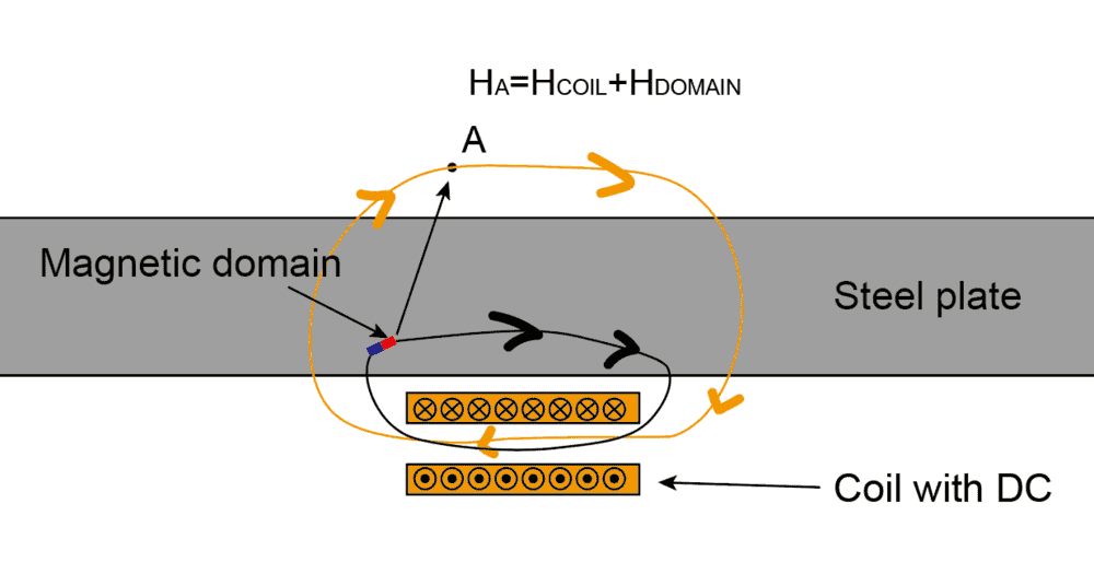

If I put a very long steel plate above a coil with DC, the magnetic field above the plate will decrease because of the shielding of the steel plate.
However, from the perspective of magnetci domain, some domains will be magnetized to turn to the direction of the magnetic field from the coil.
Therefore, the magnetic field above should be from two source. One of them is the coil, the other is the magnetic domain in the steel plate. As a result, the magnetic field should increase rather than decreasing. But in fact, the magnetic field will decrease.
This question has puzzled me for a long time. I hope someone could help me figure it out! Thanks!

I used to understand the shielding effect by magnetic flux line. But the nature of this phenomenon is that the opposing magnetic field produced by the magnetic domain in the steel plate cancels the magnetic field produced by the coil.

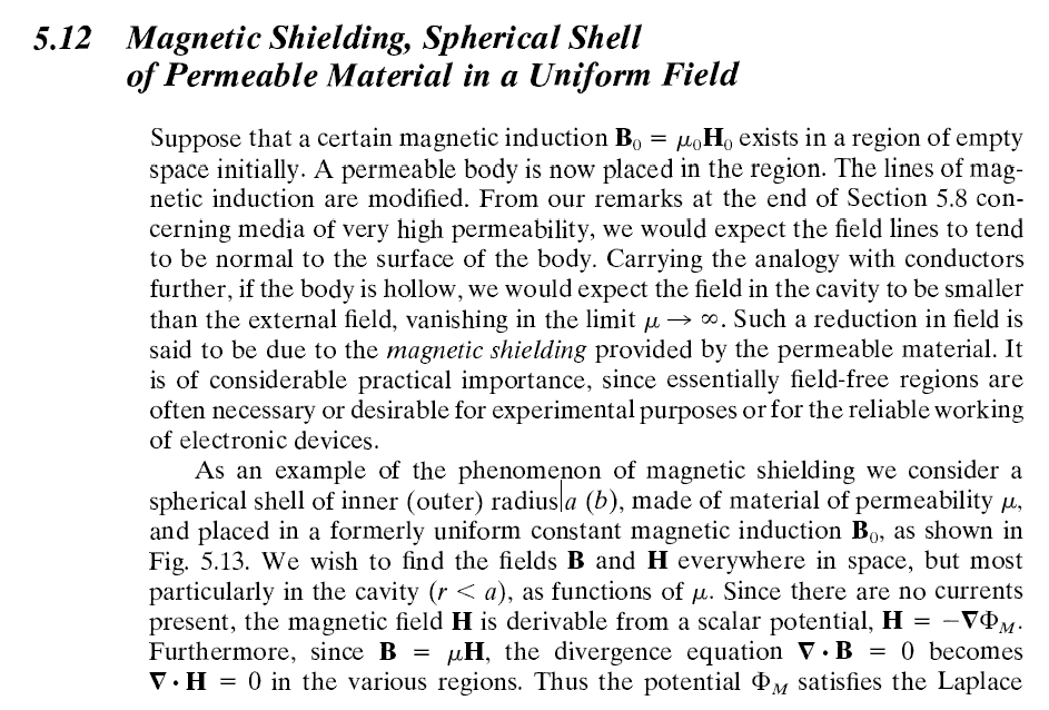

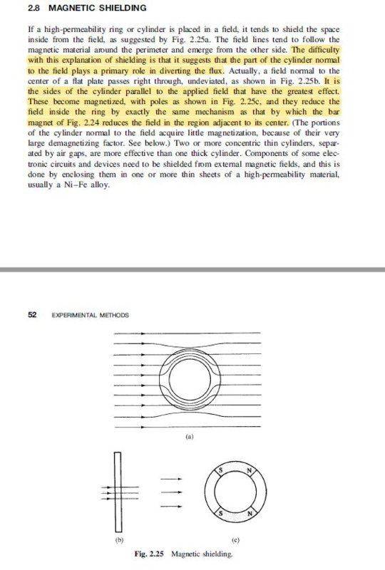

Yes, I know almost everything can be solved and calculated by Maxwell equations. What I want is to understand this intuitively like the interpretation in the book <Introduction to magnetic materials> by B. D. Cullity.

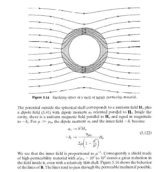

Hm, shouldn't one be able to calculate this for a simple geometry?
My suggestion is to use a spherical shell of finite thickness of some material with a magnetic permeability ##\mu_r## and calculate how the magnetic field looks given a magnetic field ##\vec{B}_0=\text{const}## at infinity. That should be easy to calculate using a magnetic potential ##\psi## with ##\vec{H}=-\vec{\nabla} \psi## (in SI units). Then all you need is ##\vec{\nabla} \times \vec{H}=0## (which is already fulfilled by the potential ansatz) and ##\vec{\nabla} \cdot \vec{B}=0##, leading to the boundary conditions ##\vec{H}_{\parallel}## and ##\vec{B}_{\perp}## continuous at the boundaries of the shell and the constitutive relation ##\vec{B}=\mu_r \mu_0 \vec{H}## with (##\mu_r=1## outside of the shell of course).
From the symmetry I think inside one has ##\vec{B}=\text{const}## and otherwise a dipole ansatz should do the rest.
👍 Yes, the magnetic field inside a spherical shell of finite thickness in a uniform field can be calculated as shown in the book <Classical Electrodynamics> by Jackson.
Great! That saves a lot of boring equation-solving to fit the boundary conditions ;-)).
