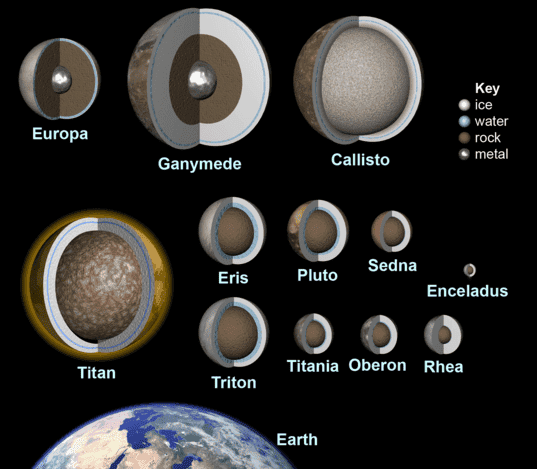

A planet or moon does not need atmosphere to be habitable. Plants, animals, humans could live in subsurface ice caverns with sealed-in breathable air and interconnecting ice tunnels. The key factor is a reliable electric power supply to supply light.
Surface habitation involves one-in-a-hundred lucky hits. Atmosphere can't be too hot or too cold, or be made of the wrong gases, or have too high a pressure, or too low. Surface gravity must be strong enough to hold atmosphere but not too strong, or you can't walk upright. Water has to be available (so many places are dry). Planets suitable for surface habitation are not common.
Ice balls with rock core and icy outer layers some hundred kilometers thick appear to be common. If humans want to establish settlements abroad they need to learn to live in subsurface ice habitats.
Some of these solar system iceballs are believed to have subsurface oceans.
The term "habitable zone" is potentially confusing. It really means SURFACE habitable zone, where there might exist a rare lucky planet that actually had surface water, and had an atmosphere the right temperature for the water to remain liquid on the surface, and a magnetic field to protect the atmosphere from erosion by solar wind etc. None of the ice-worlds shown here are in the solar system's "habitable zone" as conventionally defined even though some are believed to have sealed-in subsurface oceans.
