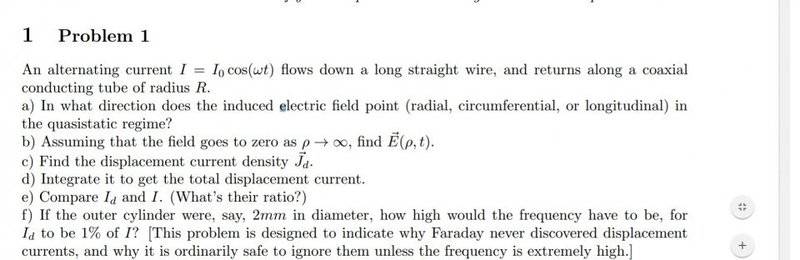

in this question i have several things to ask
1.why can't the E field in the circumferential direction?
2.How can i find the direction of B field
3.according to the formula of curl E=-dB/dt and the curlB=u J
did they share the same property so that the direction of E is circumferential (just like B dl=u i which is ampere law so that the direction B is circumferential) and dB/dt is going straight(just the the current is going straight which is enclosed inside the boundary)?
thank
  • Textbook problem 1 on an alternating current I = I0 cos(wt) flowing along a straight wire and returning through a coaxial conducting tube of radius R, with parts a) through f) asking about the induced electric field and displacement current.

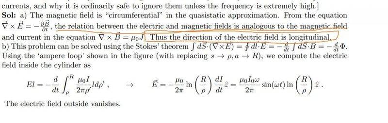

you can see this picture clearly

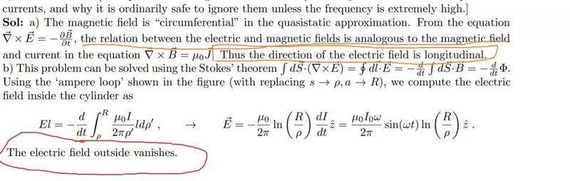

the solution states:The magnetic field is “circumferential” in the quasistatic approximation."...but i don't know how did the solution concluded "Thus the direction of the electric field is longitudinal" from the simiarlty between the relation between the electric and magnetic fields?

But Why did the Electric field outside vanished in this case?
Simon Bridge said:
In what case? Please be specific.
See the statement inside the red circle.
  • Textbook page with a solution: text on the magnetic field being circumferential, then the electric field inside a cylinder computed via Stokes' theorem, with equations E = -(mu0/2pi) ln(R/rho) dI/dt z-hat and E = (mu0 I0 omega/2pi) sin(omega t) ln(R/rho) z-hat, and the circled statement 'The electric field outside vanishes.'
Oh so the question had nothing to do with the quoted text? Fine.
To see why the electric field vanishes, try doing the problem.
because the total current inside the object is 0?
That contributes to it, yes, but the main point is the absence of magnetic charges and the fact that the problem assumes a static situation.
