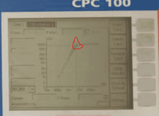

While doing the knee point test, I injected voltage upto 1500 V in a current transformer having knee point voltage 750V @ 30mA. The test was performed using Omicron's CPC 100 and it also had option to demagnetize.
Interesting - i never saw such an instrument...
in my day we'd have used analog meters and graph paper .i can't make out the display
milliamps on horizontal, volts vertical ? Knee where i circled in red?
Photo of a CPC 100 test instrument screen showing a graph of voltage against current with a straight rising line that bends flat at a red-circled knee point; axis labels are too blurred to read.
  • Photo of a CPC 100 test instrument screen showing a graph of voltage against current with a straight rising line that bends flat at a red-circled knee point; axis labels are too blurred to read.
Yes. Exactly. Voltage on y -axis and Current on x -axis. You have marked at the right place. The result was as follows
Knee point voltage -804V
Current - 5.508 mA
The Knee is just the Saturation point, viewed by exciting the Secondary ( instrument side) - so really the question is how does the designer determine the saturation limit of a transformer. So different objectives ( Price, weight, size, cost, window,) are balanced against the technical limitations. Since the window types only have One primary turn, the secondary turns is set, limiting the options of the designer. Core type ( material) and size ( think cross sectional area) - are the biggest factors.
