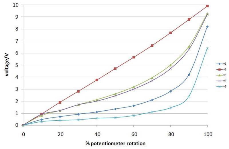

a3sportback54
The attached graph shows an experiment I performed where I had a potentiometer connected to a DC 10V supply, the voltage across the pot was measured with 5 different voltmeters of varying internal resistance. I guess the one with the highest internal resistance, to the order of 10megohm, is the straight line, v2, am I right in thinking this?
Can anyone tell me why some of the voltmeters didnt read 10V at 100% rotation?

Did you measure the resistance between the wiper and the CW contact? If it's not zero Ohms (probably isn't), then your lower-input-impedance voltmeters may still cause a voltage drop at full CW...
