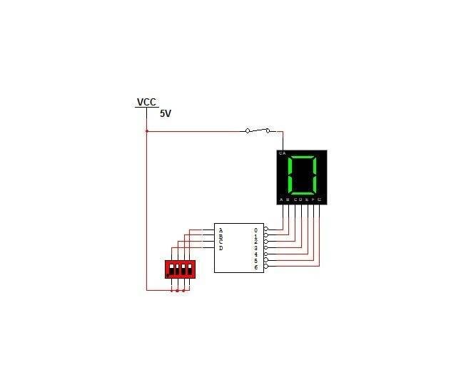

In the following circuit, none of the 7 segment LED's light up when i start simulation. I have been told that I do not need to connect anything to the LT, RBI and BI/RBO ports of the 74247 TTL. Does that affect anything maybe?[PLAIN]http://img708.imageshack.us/img708/390/7seg.png

What does the datasheet say?
You could take the wire that goes to pin 13 of U2 off U2 and ground it.
This will tell you if you have a LED problem or a driver problem because one of the LED segments should light up if you do this.
I gave my 13 year old son a simular lab which seem to work fine. Take a look, this may work for you as well.
That circuit won't work for the 74247 which is TTL.
TTL has to be pulled low to go low and that circuit gives the inputs 5 volts or leaves them open.
So they would be high all the time.
Did you try this suggestion:
The circuit has four dipswitches that feed the 7-segment decoder inputs.
This enables us to generate a complete truth table as illustrated in the data sheet.
I am currently creating EWB labs for my son where he will be simulating RC transistor oscillators driving JK flip-flops and NAND gates. He just loves it.
There are different families of logic and they have to be driven correctly.
This is an input for a TTL device:
Can you see that it makes no difference whether you connect 5 volts to A or B or just leave them open circuit?
It still counts as a "1".
To get a "0" input you have to pull A or B to ground.
