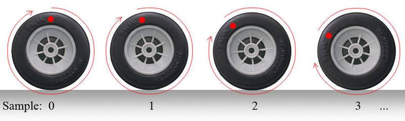

Imagine that the wheel has a bright red spot somewhere along the edge. Imagine the spot being right at the top of the spinning wheel.
Now, your eyes take 'samples' of the spinning wheel, and those samples are shown to your brain at a rapid succession so it looks like it is just a continuous stream of information.
Now, in 'sample 0' the red spot is at the top of the wheel.
If the time between two samples is arbitrary, the red spot will appear in a very different location in the next sample. And another different location in the next, etc, so it will appear as a blurry red line instead of a red spot.
Now imagine that the time between two simples is just right, so that in the first sample 'sample 0' the red spot is at the top. In the next sample, 'sample 1' the spot has rotated nearly one revolution and ended up just before the position of the red spot in sample 0. Then, in the next sample, sample 2, the spot is just before the position of the spot in sample 1, etc. This way, the spot seems to be moving backwards very slowly!
EDIT
Cooked up an image to clarify:
