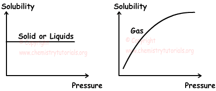

Solubility curves : Pressure vs solubility
Answer to your question : If you reduce dielectric constant of water then solubility of methyl cellulose will decrease. But if you increase the temperature then its solubility will decrease at the greater rate. This is because methyl cellulose is more covalent in nature than electrovalent or ionic. On increasing the temperature it uses that heat energy to increase its bond statistics like increasing the vander waals forces. Hence the solubility will decrease.
