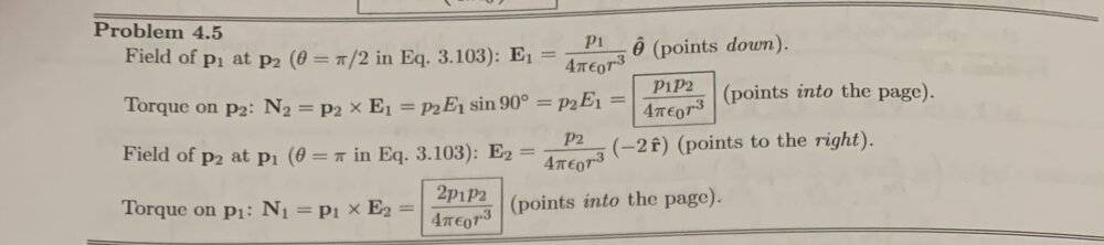

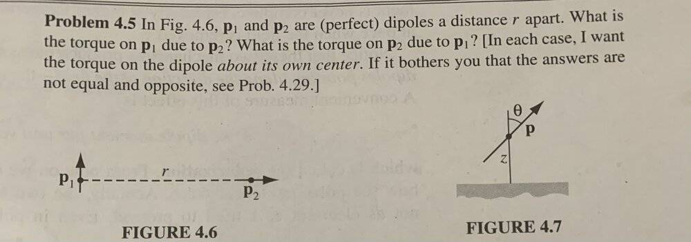

I don’t think Newton’s Third is necessarily true for torques. Problem 4.5 in the fourth edition of Griffiths Introduction to Electrodynamics deals with such a situation.
Textbook figures: Figure 4.6 shows two dipoles p1 (pointing up) and p2 (pointing right) on a horizontal line separated by distance r; Figure 4.7 shows dipole p at angle theta to a vertical line z above a flat surface.
And here’s the solution
Printed solution to Problem 4.5 showing field of p1 at p2 as E1 = p1/(4πε0 r^3) θ-hat (points down), torque on p2 N2 = p2 × E1 = p1p2/(4πε0 r^3) (points into the page), field of p2 at p1 as E2 = -2p2/(4πε0 r^3) r-hat (points to the right), and torque on p1 N1 = p1 × E2 = 2p1p2/(4πε0 r^3) (points into the page).
Torques are not the same.
I think this might be because the forces on each dipole due to the other are not parallel to the separation vector of the dipoles, i.e. in this case only the weak form of Newton III holds. So like what I said in #2, the torques are no longer negatives of one another

This is because the forces on each dipole due to the other are not parallel to the separation vector of the dipoles, i.e. in this case only the weak form of Newton III holds. So like what I said in #2, the torques are no longer negatives of one another :smile:
Ah I see your post now. That makes perfect sense.
These two torques are not around the same point, but around two individual centers.
Oh, okay I was a little bit off then, in this case. Nice catch!

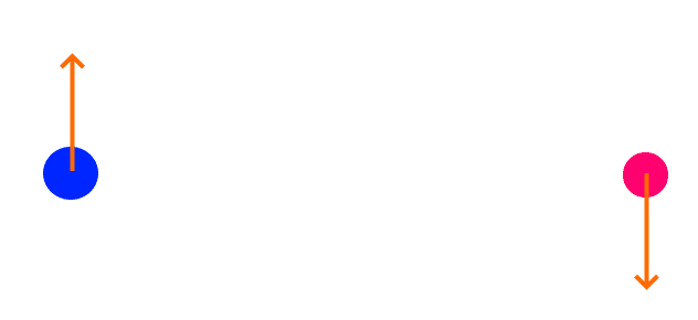

Consider there is a pair of action/reaction forces like the ones below:
Diagram of two equal and opposite forces: an orange arrow pointing up from a blue dot on the left, and an orange arrow pointing down from a pink dot on the right, both applied at offset points.
They have equal modulus and opposite directions, but they do not conserve angular momentum nor produces opposite torques around any point. So the real question is, why these forces can't be pairs of action/reaction?
My understanding is that from all 4 fundamental forces that we discovered, all of them are radial. So we cannot have this configuration. But is there any other simpler explanation? An explanation where we don't talk about fundamental particles?
Another thing we could say is that angular momentum of the universe is conserved because angular momentum is a "fundamental property". But then we are talking about fundamental particles with fixed angular momentum being interchanged to generate a torque. Is there another explanation? Or better, is there an instance where angular momentum is not conserved in a process, and instead, is transformed to anything else? We know rest mass could be considered a fundamental property, but we also know that rest mass is not conserved in the universe, because an electron can annihilate another positron.
I could have said many wrong things above, sorry if that happened. My current understanding in Particle Physics is veeeery limited. But I really want to know why Third Newton Law for rotation must be true, with no expeptions?

@Dale alluded to Noether's theorem in #5. It is pretty deep, but pretty compelling.
Ultimately, the universe behaves as it behaves. We attempt to find rules that the behavior conforms with.
Noether's theorem describes the consequences of some general classes of rules. In particular, if the laws of physics are "isotropic" (the same in every direction) and if some other conditions hold then it follows that angular momentum is conserved.
As far as we can tell, the laws of physics are indeed isotropic.
Edit: Let us try to make this more specific. Why should the fact that the laws of physics are isotropic imply conservation of angular momentum? That seems to be quite a stretch...
Consider the diagram that you had presented above in #21. We have two particles interacting. The force between them does not point along the axis between them. How was the direction of that force determined by the laws of physics?
If the laws of physics determine the direction of that force then they can either point in a particular arbitrary direction (in which case they are not isotropic) or they can point along the axis between the two particles (in which case they are isotropic).

As @jbriggs444 said, in principle they could, but such a force law would need to have a preferred direction in space. We don't know of any laws of physics that behave like that.
