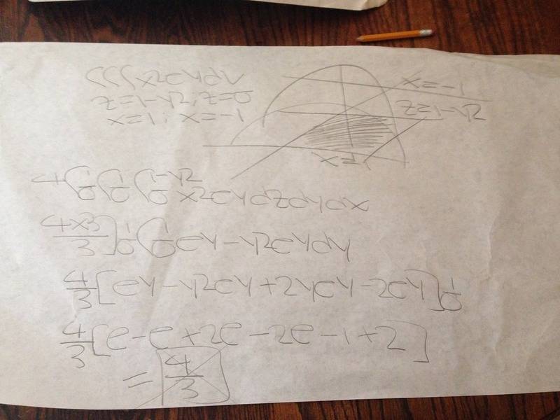

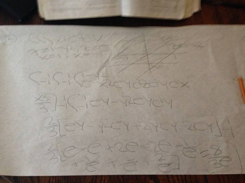

Here on problem #13 i am getting a false solution when only taking the volume of the region in quadrant 1 and multiplying it by 4. The later photo contains the correct solution which is obtained by taking the volume of the entire region. Can someone explain to me why the former is incorrect.

Just because you are calculating a triple integral, it doesn't mean you are calculating a volume. If the integrand was ##1##, you would be, and your method would be correct. But your integrand is ##x^2e^y##, and ##e^y## is not symmetric about ##y=0##. So you don't get the same answer for each quadrant.

I tried the problem myself. Is anyone else getting ##\frac{8}{3}e^{-1}##?
Yes, that's correct.
