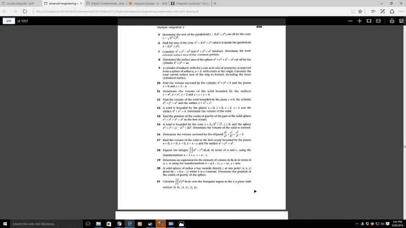

Hey guys I've been working some triple integration problems and I've stumbled across a question that I'm having problems with

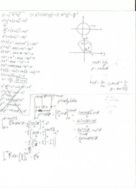

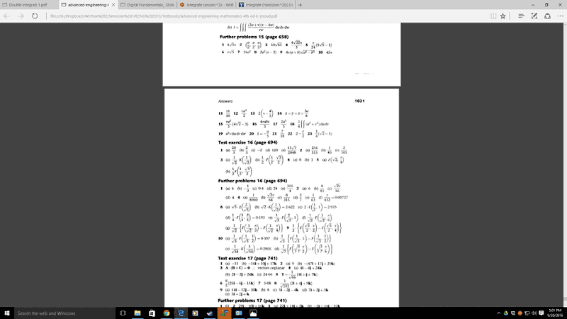

So from the picture below my solution is incorrect and I can't seem to figure out where I went wrong. Is my setup for the integrals correct or is that where I've made my mistake.
1. Homework Statement
Q15 in the posted image
(Further Problems 15 pg 658 in the solutions posted)
So I found the intersection of the two surfaces z = sqrt(x^2+y^2) and z^2 = 4(x^2+y^2) and found this to be z=2a.
On the y-z plane the solid basically leaves a region bounded by z=2|y| and the sphere. Since z=2a then y = a. I used this to calculate phi as arctan(a/2a) and rho as 2asec(phi).
In the x-y plane is basically a circle of radius a...I used this to get my range for theta which was 0 to 2π
Then I setup the triple integral as follows(With 1 as the integrand because it's a Volume calculation for the solid formed)
My Right most integral for rho goes between 0 and 2asec(phi)
Middle goes from 0 to arctan(0.5)
Left most goes from 0 to 2 pi
My answer was 2a^3/π

I suppose the following is the textbook solution.
You need to determine the intersection of the cone and sphere, not the intersection of the sphere and x-y plane.

So its the graph z= 2|y| intersected by the sphere. I then used a bit of trigs to get that cos(phi) = 2a/rho giving rho as 2asec(phi) and tan(phi) as 1/2 -> phi = arctan(1/2)So my bounds were:
0<rho<2asec(phi)
0<phi<arctan(1/2)
Ronaldo95163 said:
Ohh I see.
From there I graphed the region onto the yz plane.
0<rho<2asec(phi)
0<phi<arctan(1/2)
The equation of the sphere in spherical coordinates is not ##\rho = 2a\sec \phi##. So your "bit of trigs" is wrong. Show us how you get ##\rho## for the sphere by expressing its equation in spherical coordinates.
As an aside, since the equation of the sphere isn't particularly simple in spherical coordinates (as you will see when you work it out), this problem is actually easier to set up in cylindrical coordinates.

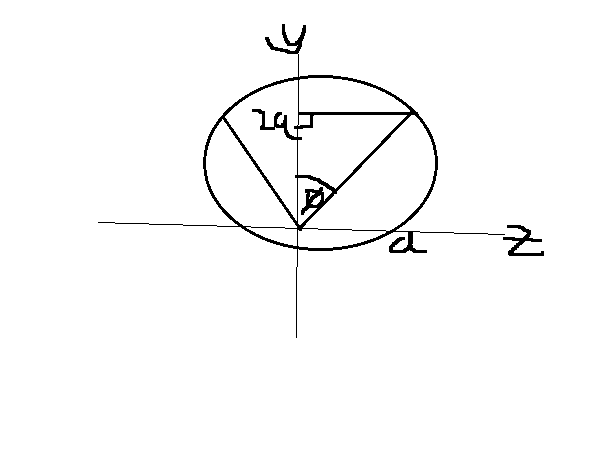

This was the diagram I used to get phi from the yz plane.
I just did cos(phi) which is 2a/rho and found rho from that to get 2asec(phi). But I understand where you're coming from...if I change the eqns I get z = 2r and z=sqrt(2a^2-r)+a.
But for spherical...I can't use the diagram like that to get rho since its the distance from the origin to a point on the sphere?
EDIT: I think i saw where I went wrong. I only set x of the cone to 0.
Setting x=0 in the cylinder gives y(sq)+(z-a)(sq) = 2a(sq)
expanding and simplifying gives y^2+z^2-2az = a^2.
From the line z=2y, I can make a substitution into that and solve for either y or z but that would get messy...I guess this is why I should have used cylindrical coordinates then?
i hope you switched the z and the y in the picture by accident ?
Woa haha yeah I did sorry about that
Now: is there any difference with the corresponding picture of the x-z plane ? Or, for that matter, with the picture of the r-z plane (##\ r^2=x^2+y^2\ ##) ?

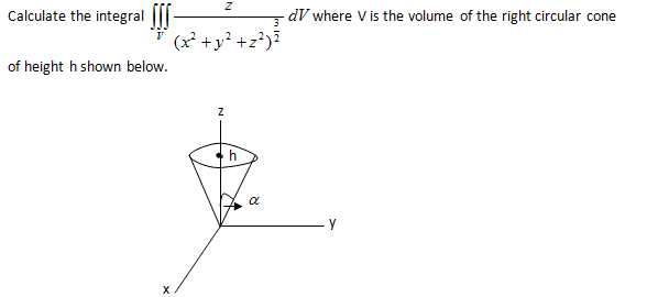

And btw is it wrong to use geometry to get rho and phi in certain cases?
For example this qn(Not switching the topic of the thread btw...just found a question where I think geometry may be applicable)
Integral of z/r3 is indeed off topic, but the integral of 1 is interesting (and pretty easy to do). The remainder of your integral is then also a lot less complicated than where you are heading with your current change of variables ...
