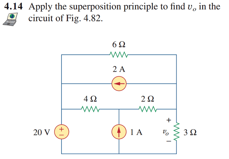

There's not much to write here except parallel resistors equation. This is supposed to be a superposition problem. How did he use a source transformation because I have no idea why and where he did the equivalent resistor and why did a current source turn into a voltage source...? Especially the placement of that voltage source. What happened?
Don't say stuff like "figure it out yourself" or give me hints because I have NO clue what to do. I don't care about the answer since it's given , I want to UNDERSTAND what is happening.
Thanks.[/B]

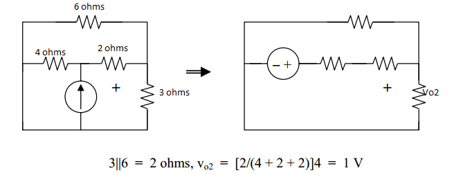

He replaced the current source and 4 ohm resistors with their Thevinin equivalent. Do you understand how to do that?

Current source is 1A .I don't know what to do in this case. To me , it looks like a source transformation but since the 4 ohms is not in series with the CS then , it is not possible.
Edit: Nevermind , it does seem like the resistor is in parallel with the CS , then why is Thevenin's theorem relevant in this problem?

The problem statement was an image only (strictly, not something that's generally allowed); no text of the actual problem was included so it was not clear what was to be solved or if there were restrictions on the methods to be used in reaching an unspecified goal. As Phinds points out, the image provided showed a source transformation (turning a Norton source into its Thevenin source equivalent). So it seems to be a permitted technique for addressing whatever the actual problem is.

Regarding the source transformation that was performed: The basic form of the Norton Equivalent is a current source in parallel with a resistance. The basic form of the Thevenin Equivalent is a voltage source in series with a resistance. These simple forms are easily changed from one to the other and perform identically as far as the greater circuitry around them is concerned. Simply draw an example of one or the other by itself and apply the usual methods to find the desired 'other' model. You'll find that it is a very simple operation. The source transformation technique can be quite useful in circuit analyses and simplifications.

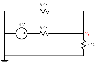

This is the part that we were discussing. From what gneill told me ,
Since the current source is 1A and the resistor connected in parallel with it is 4 ohms , It is turned into its Thevenin equivalent circuit resulting in Vth= I_No x R , Where I_No is 1A and R is 4 ohms. Hence, Vth is 4V and is connected in series with a 4 ohms resistor and a 2 ohms resistor ( middle branch transformed circuit in post #1). I do not know how to simplify the circuit from there on... My guess is to add the resistors in series and do a source transformation from VS to CS.

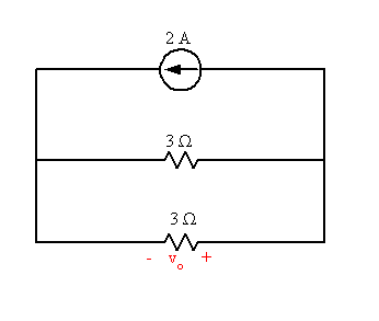

This results in 6 ohms (top branch) being in parallel with resistors 4 ohms and 2 ohms which are themselves in series with each other so adding the resistors in parallel simplifies to [6*(4+2) ]/ [12] = 3 ohms. I guess the other part is just a matter of mesh or nodal analysis ? (Correct me if I'm wrong).

Yes, that is certainly one way to go. You'll then find another opportunity to combine resistors to simplify things. Alternatively, apply nodal analysis at this point; there's only the one essential node and it conveniently has vo as its potential. Presumably since the objective is to use superposition, once you select a single source and suppress the others you are free to apply any techniques that you know in order to find that source's contribution.

Plenty of choices there. Certainly nodal analysis will work. Since everything is in parallel you could do current division, or convert the whole thing to its Thevenin equivalent.
