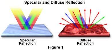

If the color black absorbs all colors and reflects none and the color red absorbs all colors but reflects the color red and the color white is made up of all colors no absorption and all reflection how come the color white is not a mirror?
For one thing, the reflected light is scattered in all directions and is therefore incapable of conveying an image.
As Danger says:
Diagram titled Specular and Diffuse Reflection, Figure 1: on the left, a smooth blue surface reflects a bundle of multicolored light rays at a single angle; on the right, a rough red surface scatters the same rays in many directions.
So when we see the color white we are seeing all colors reflected in a chaotic ( diffused ) manner with no one color dominating on both the absorption and reflection sides of the coin?
In the picture of diffuse reflection you show an uneven surface but what about a smooth surface like a white car bumper?
Car bumpers are not smooth when you get down to nanometer sized scales. In addition, light is partially penetrating the material a small ways before being reflected back out, which can cause scattering and other effects.
You can have a smooth, but mostly transparent layer, which causes some specular reflection at the surface. But most light penetrates the surface and gets diffused below it.
Also, there are a lot of different "whites". Not all frequencies are reflected equally by most of them.
