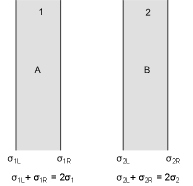

Consider a single conducting infinite sheet with surface charge density ##\sigma_1## on each face and total charge density ##2\sigma_1##. The electric field it generates is obtained from Gauss's law. The electric flux through the usual "pillbox" is ##\Phi_E=2EA## and the enclosed charge is ##q_{enc}=2\sigma_1A##. Application of Gauss's law gives the magnitude of the electric field, ##E=\sigma_1/\epsilon_0##. The direction of the field is perpendicular to the sheet and away from it on either side. (we assume that ##\sigma_1>0.##) We can view this as the superposition field produced by two sheets, each generating field ##E=\dfrac{\sigma_1}{2\epsilon_0}.##
So to model this, we charge two sheets, bring them close to each other and let the surface charges go wherever they want. We will consider four surfaces each producing its own field. Using subscripts 1 and 2 to identify the sheets and L and R for "left" and "right", we have $$\sigma_{1L}+\sigma_{1R}=2\sigma_1~~~~~(1);~~\sigma_{2L}+\sigma_{2R}=2\sigma_2~~~~~(2)$$Now look at the drawing below. We know that inside conductor 1 at point A the electric field must be zero. By superposition, it is also the sum of four contributions from the four distributions, one to the right from ##\sigma_{1L}## and the other three to the left.
We write for the total field at A, $$\frac{\sigma_{1L}}{2\epsilon_0}-\frac{\sigma_{1R}}{2\epsilon_0}-\frac{\sigma_{2L}}{2\epsilon_0}-\frac{\sigma_{2R}}{2\epsilon_0}=0$$Using equations (1) and (2) and simplifying,$$\sigma_{1L}-(2\sigma_1-\sigma_{1L})-2\sigma_2=0~\rightarrow~\sigma_{1L}=\sigma_1+\sigma_2$$Then$$\sigma_{1R}=2\sigma_1-\sigma_{1L}=\sigma_1-\sigma_2.$$ You can follow the same procedure to find the remaining two distributions by demanding that the electric field be zero at point B or you can note that there is left-to-right symmetry which means that you can swap subscripts "1" and "2" and subscripts "L" and "R" to get,
$$\sigma_{2R}=\sigma_2+\sigma_1~;~~~~~\sigma_{2L}=\sigma_2-\sigma_1.$$Once you have the four distributions, you can find the electric field anywhere. For example, between the plates,$$E_{between}=\frac{1}{2\epsilon_0}(\sigma_{1L}+\sigma_{1R}-\sigma_{2L}-\sigma_{2R})=\frac{\sigma_1-\sigma_2}{\epsilon_0}$$This method is straightforward and can be easily extended to more than two plates. If one of the distributions is given to you as negative, then just flip its sign in the above equations.
