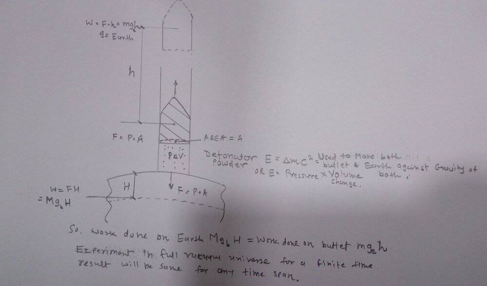

"The initial momentum was zero because nothing was moving. The final momentum must also, therefore, be zero."
How final momentum zero? both boats will continue to move with (infinite time like they are in full vacuum space) constant speed as there are no other forces considered. Momentum must be related to time as per F = dp/dt = m*dv/dt = ma
Force = mass x gravity value on earth. now multiply with height h = mgh that is work for object. same is applicable to Earth case. Here, gravity of object on Earth to be considered. So, mgh Earth =mgh object. And 1/2mv2 object = 1/2MV2 Earth.

  • #43
How final momentum zero? both boats will continue to move ...
Momentum is a vector. Equal but opposite vectors cancel to zero.
  • #44
rajen0201 said:
"The initial momentum was zero because nothing was moving. The final momentum must also, therefore, be zero." How final momentum zero? both boats will continue to move with (infinite time like they are in full vacuum space) constant speed as there are no other forces considered.
The momentum of each boat is non-zero, yes. The sum of the two, however, is always zero because of the conservation of momentum. That is, the momentum of one boat (##mv\neq 0##) and the momentum of the other (##MV\neq 0##) added together are zero.
