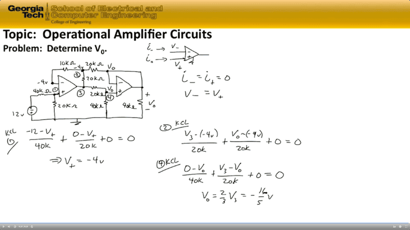

Determine V_0 in this operational amplifier circuit.

The last non-black frame of the video is attached as TheProblemAndItsSolution.png, as shown below.

What I don't understand is that the instructor is saying that he defines the current for node 1 as going into the node, but then gets a -12, as opposed to a +12, in (-12 - V_+) / 40k. Shouldn't it be (12 - V_+) / 40k (notice that I purposely omitted the minus in front of the 12)? My logic is that if the current is going from the voltage source to node 1, then the current would first cross the positive terminal of the voltage source.
If someone could help me understand what's going on here, I would greatly appreciate it!
The +ve terminal of the 12V source is connected to ground, it is the -ve terminal that is connected to the 40k resistor.
Oh, so, it's just a matter of recognizing that the current, when flowing into node 1 (as defined by the instructor) (as opposed to away from it) and using the passive sign convention, the terminal of the resistor where the current goes into the resistor is positive and the voltage source's positive terminal should be connected to the resistor's positive terminal since, given the aforementioned assumptions, current flows from the negative terminal of a voltage source to its positive one and then from the positive terminal of the resistor to its negative one?

All right, so
V_out = _V_in * Z_2 / (Z_1 + Z_2)
V_out = (-12 V)*(20k ohm) / (20k ohm + 40k ohm)
V_out = (-12 V)*(1/3)
V_out = -4 V
V_+ = V_out = -4 V
This does seem to be in agreement with what he found using nodal analysis, by the way.

Why is it (-12 - V_+) / 40k + (0 - V_+) / 20k + 0 = 0 instead of (V_+ - -12) / 40k + (V_+ - 0) / 20k + 0 = 0 ⇔ (V_+ + 12) / 40k + (V_+ - 0) / 20k + 0 = 0 (since what the instructor gives is what I get from my logic but multiplied by -1, which doesn't change the final result since the other side of the equality is 0)?
I realize that those equations are equivalent, but I'd like to make sure that I don't get the right answer for the wrong reason(s).

I don't understand what you are trying to say here, so I will explain it in my own words.
  • By Kirchoff's first law, the sum of (signed conventional) currents flowing into a node is zero.
  • Current flows into Node 1 from the 40k resistor from left to right (note that this current may be, and in fact is, negative and so conventional current actually flows from right to left away from Node 1, but we don't worry about that because the sign convention will take care of everything for us).
  • The left end of the 40k resistor is connected to the -ve terminal of the voltage source and is therefore at ## -12\text{ V}##, the right end is connected to ## V_+ ## and so the current flowing into Node 1 from the 40k resistor is ## \frac{-12 - V_+}{40\text{k}}\text{ A}##.
  • The bottom end of the 20k resistor is connected to ground and is therefore at ## 0{ V}##, the top end is connected to ## V_+ ## and so the current flowing into Node 1 from the 20k resistor is ## \frac{0 - V_+}{20\text{k}}\text{ A}##.
  • Node 1 is connected to ## V_+ ## and because this is an ideal op amp no current flows to or from Node 1 to ## V_+ ##.
  • The sum of these three currents is equal to ## 0 ##, giving the expression in the slide.
Because we have decided to measure the conventional currents flowing into Node 1.
Because that measures the conventional currents flowing out from Node 1.
Each is equally valid, because by Kirchoffs current law they must each sum to zero, and so the choice is arbitrary, however in order to reduce the possibility of error it is a good idea to always choose the same one, and by convention we choose to sum the conventional currents flowing into a node.

Ah! I think I get it, but just to make sure (I suppose, by reiterating what you said, but in my own words):
* It's just about using the assumed direction of the current with the passive sign convention to know which part of the resistor is assumed to be the high potential difference and which one is the low point, right?
* Then, for the -12 V instead of 12 V, since the potential difference goes from high to low as opposed to going from low to high when the current it produces goes toward the 40k ohm resistor, we tack on a negative, right (since the voltage source is supposed to energize / incite (positive) charged particles to go to the 40k ohm resistor and then the kinetic energy of the (positive) charged particles would be lost when "consumed" by that aforementioned 40k ohm resistor)?
I hope I'm not confusing you again :P, but I think I get it. I just need to see other similar problems and see if my thoughts also work for those problems too.
No. Forget about the passive sign convention, it doesn't help you with Kirchoffs laws. And we don't need to think in advance about which way electrons, holes, or anything else is flowing or which end of the resistor is at a higher potential.
We start off by assuming that the current from the resistor into N1 i.e. from left to right, and this is the potential difference between the left hand end and the right end i.e. V_left - V_right = -12V - V_+.
If it turns out that this gives a negative value for current then that's fine, it means that the conventional current is actually flowing from right to left (although of course the only thing that is actually moving is electrons and they move in the opposite direction to conventional current).

There are some, however, that need only a single supply. A single-supply op-amp typically can not handle inputs around Ground level.
What about if there is one voltage source and one current source? Polarity still matters then, right?
Right!
Cheers,
Tom
