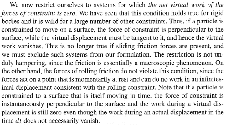

In pure rolling, is the virtual displacement parallel or perpendicular to the surface? I believe it can't be perpendicular because the object is not allowed to lose contact with the surface. But if it's parallel, then there must be a non-zero virtual work done since the rolling friction is also parallel to the surface. The book says the point of contact is momentarily at rest, does that mean that the virtual displacement must be zero (but the actual infinitesimal displacement is parallel to the surface)?

As posted with the original question:
The book clearly says there are systems for which the net virtual work of the forces of constraint is non-zero and there are those for which it is zero, and rolling friction belongs to the latter class.
how come i read differently the same quote shown above - it does say that work done in virtual displacement is zero even when in real /actual displacements it may not vanish...also it says that rolling friction obeys the principle of virtual work.
Read it again? "The net virtual work of force of constraint is zero." "this condition holds true for rigid bodies ... the virtual work vanishes." "This is no longer true if sliding friction forces are present"
Basically, your argument is that virtual work always vanishes, so the virtual work for rolling friction must vanish too. But virtual work does not always vanish. The virtual work for rolling friction indeed vanishes but your argument is incorrect.

"This is no longeconsr true if sliding friction forces are present"
then read the line that these will not be part of this formulation <We must exclude such systems from our formulation>
Ermm.. I know we must exclude them. This wasn't my question!
