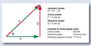

Because P and Q have perpendicular directions. Thus Pythagoras must be used.
This is circular reasoning. We defined it to be that way!

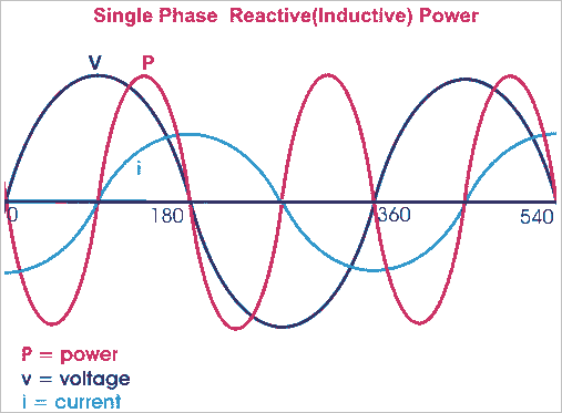

A picture is generally wort a thousand words.
It was helpful for me to look at sinewaves:
draw two of them one above the other
label one Volts and the other Amps
draw a pair in phase,
a pair 180 degrees out of phase,
a pair 90 degrees out of phase and
a pair 45 degrees out of phase
then consider instantaneous power, product volts X amps
For the in phase sinewaves , product is always positive , P = volts X amps, which represents power factor of 1.0 (cos 0 degrees)
for the pair 180 out, product is always negative, power = volts X amps and one of them is always negative , power factor = -1.0 which is cosine 180 degrees
for the others , power is sometimes positive and sometimes negative , over a complete cycle it will average to VIcosθ,
that's what reactive power does - shuttle back and forth between source and load during subcycle intervals.
At 90 degrees observe positive and negative intervals are equal and their average power is zero, e power factor of zero which is cos 90 degrees. Nothing gets hot or does any work.
At 45 degrees - would someone less awkward copy and paste some sinewaves into Paint and post ? That's been done someplace on PF (i remember doing it) but i was unable to find, and paint frustrates me terribly.
You'll find P = VICosθ and Q = VISinθ , and Pythagoras Rules !
I think that visual exercise is a good learning tool. It'll cement the concept.

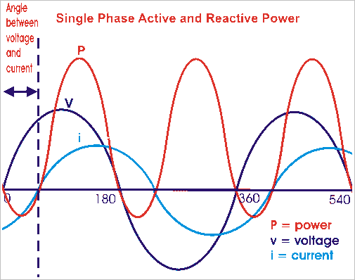

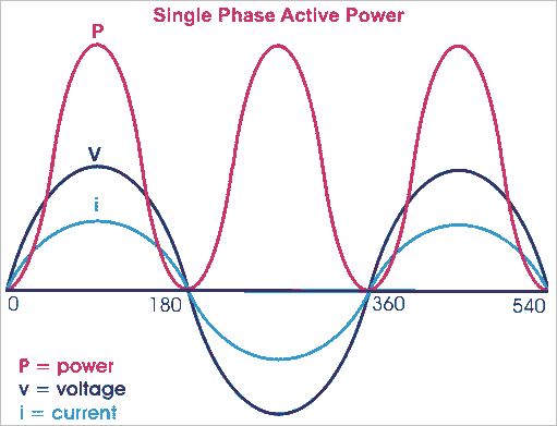

aha found it
single phase volts, amps, and power
when volts and amps are in phase ie power factor = 1
observe instantaneous power is always positive
single phase volts, amps and instantaneous power
when volts and amps are out of phase by 90 degrees
observe instantaneous power no longer unipolar, in fact averages zero; cos(90degrees) = 0...

vintageplayer said:
The peak power it draws is equal to Q.
vintageplayer said:
That value is the "reactive power" Q agree?
no i don't agree.
do we have a definition of terms question here?
Where would you select peak power on that graph? Copy&paste into Paint and add an arrow...
I'd guess Q is average of the orange power wave .
those graphs came from http://www.electrical4u.com/electric-power-single-and-three-phase/11
For a purely reactive component p(t) = (VI/2).sinφ.sin(2φ - 2wt). Q is therefore the peak value of the AC power waveform.
When you have both resistive and reactive components, p(t) = (VI/2)cosφ[1 + cos(2wt)] + (VI/2).sinφ.sin(2wt). Q is the peak of the sine component, but there is no nice way to show it graphically without drawing the sinusoid components separately.
The real power P = (VI/2)cosφ is the average of the power wave, not Q.
